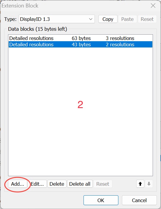

I managed to get DLDSR with CVT-RB2 timings working for 10bit 120hz and 144hz with CRU. I suspect going higher should work fine but haven’t tried as I like 144 being a multiple of 24. Tbh 120 is probably plenty and you get 24/30 then plus 5k2k is hard to hit 144hz with the 3080 anyway.
There was indeed some sort of nv driver issue at play. I did a DDU in safe mode, deleted the display I modified in CRU and rebooted installing latest dec 1st whql drivers from nvidia. After that I was able to use CRU to add a new extension block with custom resolutions and rebooted. Enable DLDSR factors in nvcp, then set the resolution, scaling and refresh from windows 11 settings panel and confirmed it was correct in nvcp.
As an added bonus DDU fixed the bug where only enhanced and reference mode works in nvcp and accurate can’t be selected. Presumably I touched the sliders at some point and reset to default wasn’t cutting it to get accurate back.
I’ll post the CRU screens in a bit once I get back in.
Please do!
1) select DisplayID under extension blocks and hit edit. By default it should say 1 data block but I’ve already added 144hz here.
2) click add at the bottom. By default you won’t have the selected block.
3) click add at the bottom again. By default there will be nothing here.
4) Select CVT-RB2 from timing drop-down and enter the refresh rate. You could do manual and calculate them like the custom resolutions in nvcp which doesn’t have RB2 but that’s more work. Hit ok when done.
5) repeat for more refresh rates if you want. Otherwise hit ok.
6) back at extension blocks hit ok again.
7) and hit ok again at the bottom of the main CRU window.
8) you can run restart.exe or reboot now. Restart.exe is probably safer if you made a mistake somehow.
This is where nvcp originally flipped out and display options disappeared but if that happens safe mode DDU and install the latest drivers again. That fixed it for me.
If it all worked you should be able to enable to DLDSR factors and then select 5k2k and set the refresh rate to 144hz or whatever you added under advanced adapter settings from windows settings or from the nvcp resolution panel.

Yup, that worked really well. Many thx! Image 1 and Image 2 is what I wasn't sure about. I did use DDU before trying it out. I had too many left over from all the test I did.
I like your argument for 120Hz, so I'll probably stick with that.
Using CRU is a much better way for playing with custom resolutions and refresh rates then using nvcp custom resolution panel, that thing is bug ridden.

HDR calibration puts both max luminance and full screen max luminance at 530 for me. These are way lower than what most people are getting on Reddit for the dw.
Looks like we can edit it with CRU though. Not sure I want to touch it until I understand why it’s so low to begin with.
