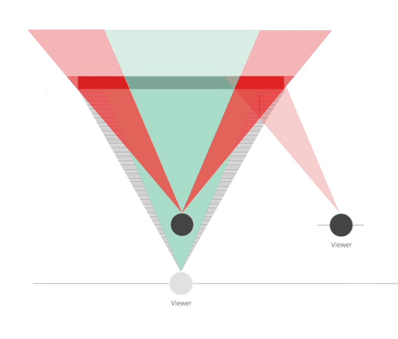

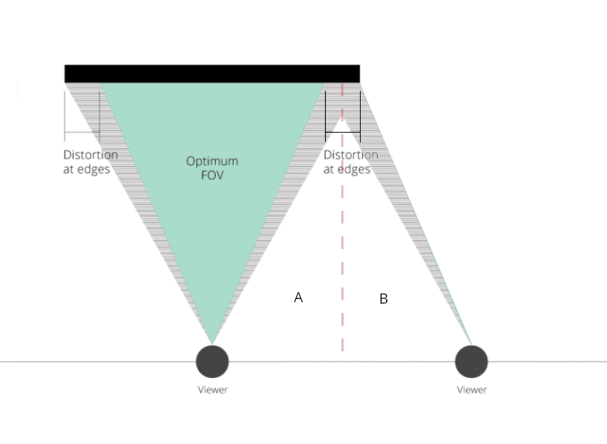

>This graphic shows the optimal viewing distances of both a 42" 4k and a 48" 4k, plus a lower 50-ish PPD one at 24" to show how a lot of people are viewing one on a desk sub-optimally at \~ 1500p like PPD.
>Human viewing angle is 50 to 60 degrees
>optimal viewing angle minimizes the off axis and non-uniform edges
>Sitting too close pushes the sides of the screen outside of your viewpoint and makes the off-axis areas larger:
TLDR: When relaying how text aliasing/fringing, graphics aliasing, etc. look on different monitor sizes and specs it's more meaningful if you include the PPD (or the true viewinng distance to your eyeballs at least). A 42" 4k at ~ 24" view on a desk is only ~ 51 PPD which maps pretty close to what ~1500p would look like on a desktop monitor. Someone viewing text at 64PPD or ~70PPD with optimal viewing angles on a 4k that is decoupled from the desk is going to see thing much differently - seeing much smaller pereceived pixel sizes, much less granularity.

The 3440x1440 alienware is 1800R, , 1800mm . . 71" radius (or focal point) which is extremely broad, a very slight curve section of a very large circle so I probably wouldn't even take the curve into consideration in this case with this small of a screen.
You can sit closer of course but when you sit closer than the focal point of the curve the curve distorts things since the pixels are instead pointing at a location behind you rather than where you are sitting.
The solid blue is the 1000R viewpoint, the transparent field is when sitting nearer. There is some wiggle room like the first example but the 2nd example is poor imo.
The 42" and 48" 16:9 optimal viewing angles and what distances are in the other image I posted (along with a 24" view distance I added to show a sub-optimal desktop placement)
Human central view is 60 to 50 degrees.
There is some wiggle room there but that is optimal, focal + color field. Past that you are pushing the sides of the screen well out into your periphery (as well as lowering your PPD more, making the pixel sizes appear larger).
60 deg 4k is 64 PPD but the 60PPD point isn't pushing the screen edges out by that much more at 65deg viewing angle or so. Non standard subpixel layouts and the uncompensated for 2d desktop's graphics and imagery can benefit from a lot higher than 60 PPD but it's a good reference point for rgb text with rgb sub-sampling (or any text-ss mapped appropriately to other non-standard subpixel structures in the future).
That one link I showed is pretty useful. You can plug in any size screen and just scale the distance up/down until you see 50 deg and 60 deg.
Ultrawides, super-ultrawides, and curve radii complicate things a bit.
If you look at an ultrawide as a central 16:9 + wings on the sides, you might consider that central 16:9 monitor space as where you'd want to get near to the 60 to 50 degree viewing angle, using the rest of the screen for peripheral immerison (driving, flying games especially), and as head/eye turning desktop app real estate like a multi-monitor setup but without bezels. You could sit farther away than that and get somewhat higher PPD as well as seeing more of the screen's width in your central view all at once, and some people do, but then the screen height would shrink to your perspective so it isn't optimal to sit much farther vs perceived screen height after a point. Imo then it ends up like a short belt instead of a "full height" field.
With curved screens the R-value is the radius of the screen, which equates to the focal point if the curved screen was considered a lens. E.g. 1000R = 1000mm = around 40" radius/focal point. Most people end up having to sit too close to a curved screen so that the focal point of the curve is a location farther behind them unfortunately. That means the pixels outside of the center of the screen won't be pointed at your eyes. Another way to say that is that they are off axis.
As an analogy, think of them as a grid of laser pointers on the curve - in a room with a fog machine. If you were sitting at the focal point of a large 800R (~35" radius/focal point) curved screen for example, every point on the screen would be pointed directly at your eyeballs so you'd be seeing just the points of light almost entirely. If you were sitting say 26" away from a 1000R curved screen that was mounted on a desk, all of the laser pointers would be pointing at a location 14" farther behind you (40" radius). In the fog machine room in the 26" desk view distance example you'd be seeing oblong points and the sides of the light shafts instead of the lights pointing directly at you on the sides, and to greater degree/longer the farther away on the curve. That results in more image distortion like a funhouse mirror. People blame game devs for not "fixing" this with warping compensation methods but if you had a curvature more appropriate to your screen size vs view distance this would probably be much less of an issue in some games. Some devs do literally stretch the displayed content though like tv's "scale 4:3 = stretch" modes did and that is a problem.
To answer your 34" 21:9 optimal view distance/optimal viewing angle question, I'd say that depends on what game you are playing and whether you are using it for desktop/app real-estate at any given time, and probably your personal taste to a degree.
A 34" 3440x1400 screen could be looked at essentially as a 27" 16:9 2560x1440 with 440px of wings on each side, bezel free.
440 + [27" 2560] + 440
In order to get the full height to your perspective you'd have to stay near to the 60 to 50 degree central viewing angle on the middle portion. You could choose to essentially shorten the screen to make it more belt like and see more of the sides of the screen in your central viewing angle though, fitting the entire screen width closer to 60 to 50 degrees. That would be more like cutting a screen in half vertically rather than expanding a full height screen's width if you get what I mean. 1/2 field height + full field width . . vs . . full field height + wider than full field.
2560 x 1440 27" 16:9 screen 60 degrees and 43 PPD at ~ 20.5" view distance <--- same for 34" 3440x1440 ultrawide if using full field height + sides as peripheral
2560x1440 27" 16:9 screen 50 degrees and 51 PPD at ~ 25" view distance <--- same for 34" 3440x1440 ultrawide if using full field height + sides as peripheral
3440 x 1440 21:9 screen 60 degrees and 57 PPD at ~ 27" view distance <--- "half" field height, full field width
3440 x 1440 21:9 screen 50 degrees and 69 PPD at ~ 34" view distance <--- "half" field height, full field width
