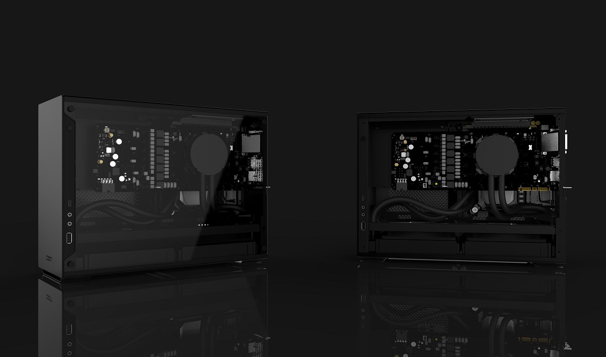

Yes, it willSorry if this has been answered previously. With the case being able to accommodate a 240 rad, will this be able to fit two 120 AIOs? One for CPU and one for GPU?
the problem with this config is that the pumps are now the high points. so any air in the aio, which there is usually a little, will collect there causing potential noise and or wear. custom is this case might eliminate that. its kinda late but the rads at the top would be the better option, shift everything else down.
well there ya go. guess I missed that part, oops!
Can we talk about physics for a second? How is a heavy card hanging like a bat from the little plastic PCIe lock secure? Am I missing something? Is it as secure as in the right-side-up orientation, and if so how?
The card weight is supported by the PCIE bracket(back of the case) not by the PCIE slot.
Some of it yes, but without the slot I assume it's not going to fare well under stress. The slot stabilizes it, but there has to be stress on the bracket. The bracket is designed with gravity in mind. So I don't really get how it's secure like that. Do the "feet" of the bracket insert into anything?
