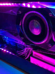

While we're all talking about blower style cards, I've got a 1070FE, and need a shroud to stop it sucking in the cold... sorry... hot air from my AIO.
Is anyone aware of where I can get this sort of thing? Maybe 3D printed? Maybe a ghetto solution?
And I'm in Australia......... :(

You can get foam tapes, for example 7mmx7mm from home hardware supply stores. They are to prevent drafts in Windows/doors. I would think they would be good, you could stick it to the case panel or the GPU easily enough.

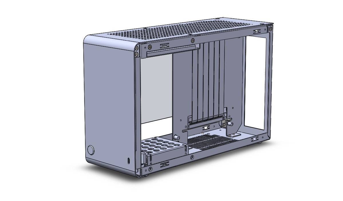

Hi guys here are all changes for A4-SFX v4
- ADT 185mm PCIe x16 gen 3 riser
- USB 3.0 Typ-C to 20pin intrnal header (90% confirmed)
- changed to the drive bay so it will support 15mm thick drives
- added thread for easy installation of custom window kits
- adding 92mm fan support under the motherboard
- lifting up motherboard for better bottom fan clearance
- the 120mm AIO bracket will not be included and an optional part on SFFLab
With best regards
Daniel

That fan underneath the motherboard should help cpu temp big time. Just purchased v2 used few weeks ago. Very nice case but seeing the v4 i should have waited instead :(
