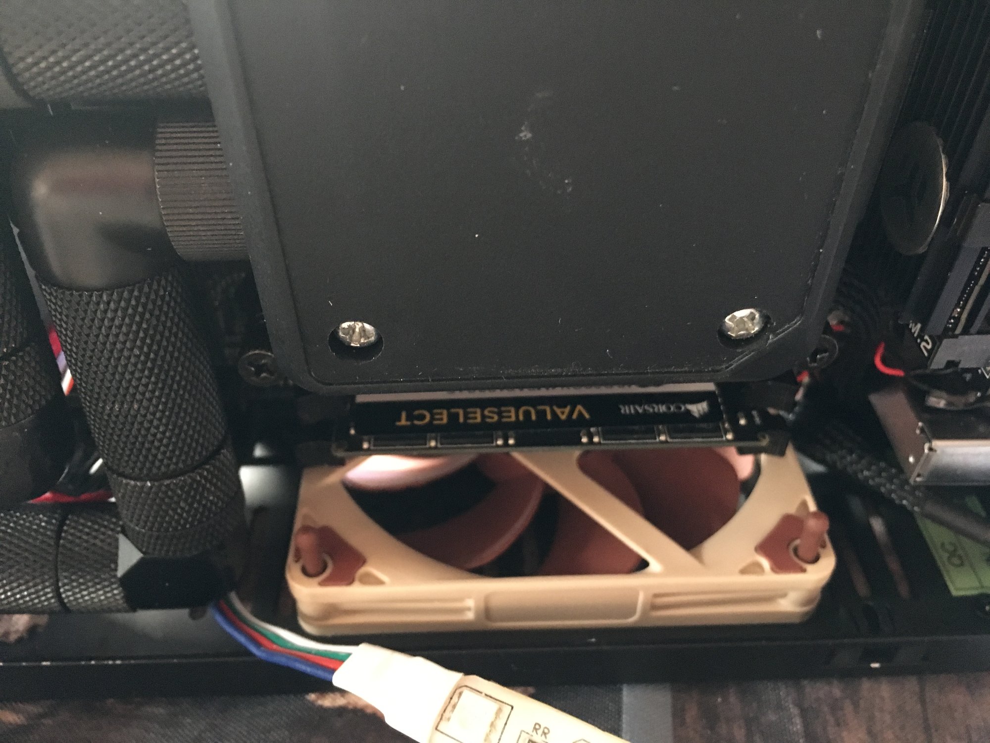

Is it a 92mm fan you have below?
Just 80, but i only tested direct to psu,
so i can't say much more, fits well just every 80x10 below the case,
moves a lot of air but noisy at max speed,
i hope that should work at 50% and with low noise....

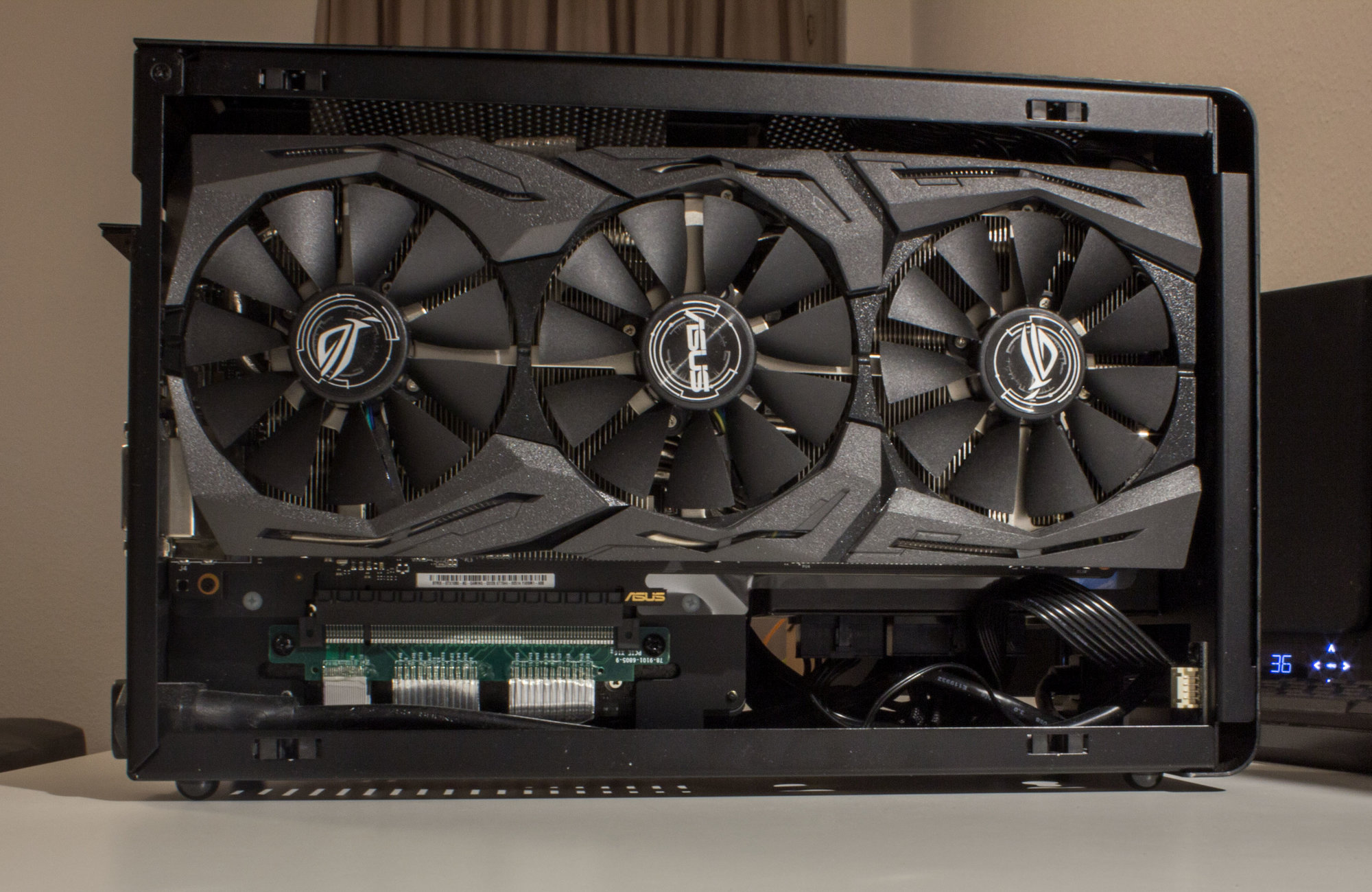

Hello there,
I had some time on my hands so I decided why not take some pictures and share them.
Build:
i7 7700K
Asus Strix Z270I
32GB Corsair Vengeance DDR4-3000
GTX 1080 Asus Strix
Be Quiet SFX-L 600W (Noctua A12x15 PWM controlled via Mainboard ChaFan)
Cooltek LP53 (Noctua A9x14 PWM)
CableMod Custom Length 24 Pin and 8 Pin
and a Samsung 960 Evo 1TB (not detected after Windows reinstall, RMAed)
Noctua all the things!
I thought about replacing the shroud of the GTX 1080 and put two A12x15 on it.
But all the 1080 I had (including this one), had terrible coil whine even with capped FPS, so it's not getting better with quieter fans.
In the end, the best fan to put down the case is the:
Noctua NF A9x14
Yes, it's a pain to mount, you should be VERY DELICATE withe the raiser, you have to extend at maximum...
And you should be SUPER VERY DELICATE when screwing motherboard in place...
you are doing it at your own risk, I do not take any responsibility, man advised !!!

Did you drill holes for the mounting?
