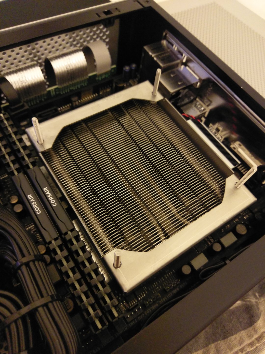

Mosfet heatsinks will do the job, something like these, The C10 version probably fits too, but I didn't notice them until after I installed the C1's.
So take the heatsink off and just put these on? Do I put thermal paste on the heatsink and just stick them to the VRM? Sorry for the questions, farthest I've gone with modding is taking a sticker off a case lol.
They come with adhesive thermal pads, you just take the heatsink off, clean the VRM's if necessary (I did with Methylated Spirits), then stick these on.
I should note, I've not noticed any improvement (or worsening) of temperatures, I did this purely because I wanted clearance for Dan's upcoming cooler.

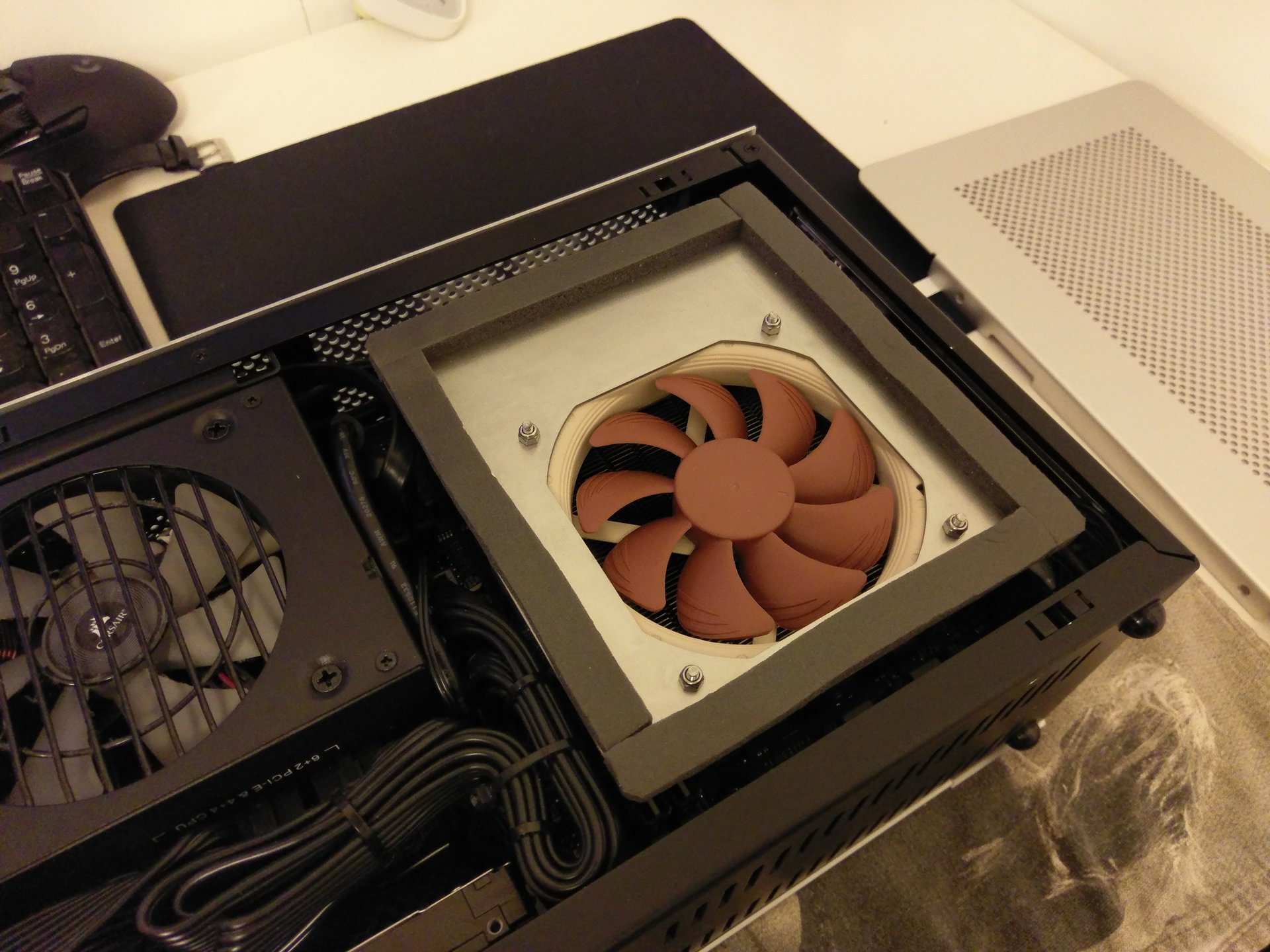

After sitting on my desk for month, I finally got my build together. Strix 370, 8700k, MSI 1080 and an AXP-100 full copper. The current blocker is the missing delid-die-mate 2. It is simply unavailable :( Can someone recommend an alternative?

Adafruit also has multiple fitting heatsinks. One MOSFET is around 6x6mm which means your heatsink should preferably have a width and length of roughly 6mm. (0.25-0.27inch from Adafruit work for example).
If I remember correctly Z270i has 11 MOSFETs which means you should use 11 heatsinks. I assume the Z370i is the same, maybe buy 15 to be on the safe side.

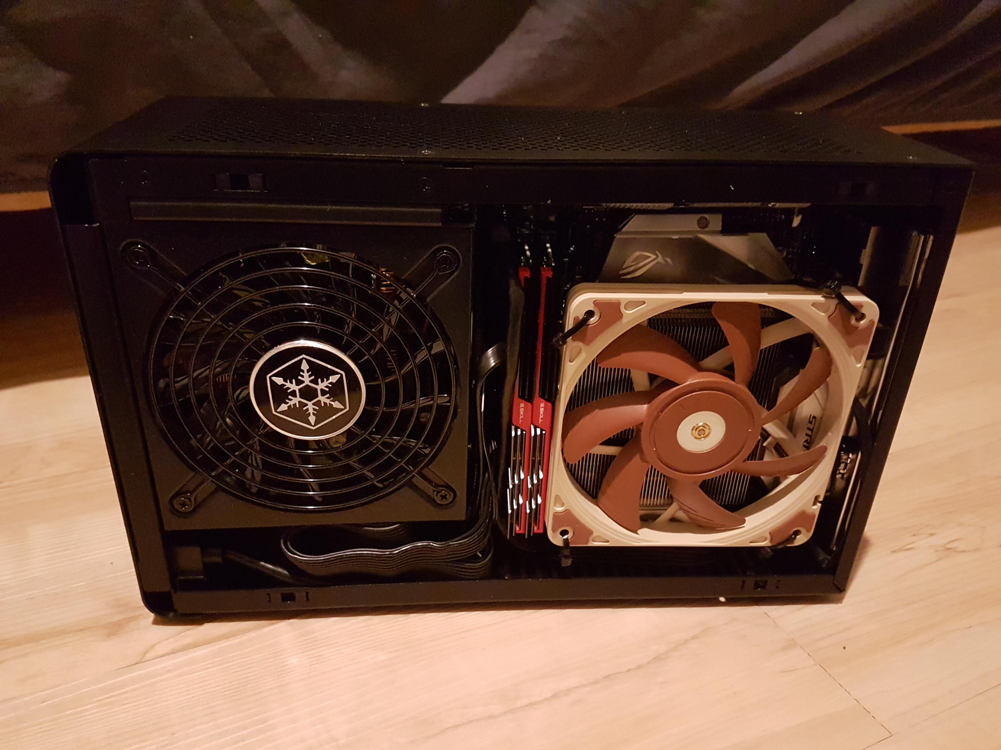

Looks good. CPU heatsink: Cooltek LP53 + Noctua A9x14 fan :)
Thanks! I was afraid that you'd tell me the GPU wouldn't fit (since I already placed my order…). :p
How do I assemble the heatsink and Noctua fan? I suppose it requires removing the heatsink's original fan and placing the Noctua in its place, right?
exactly. Usually people use some zip ties to mount the new fan on the heatsink.

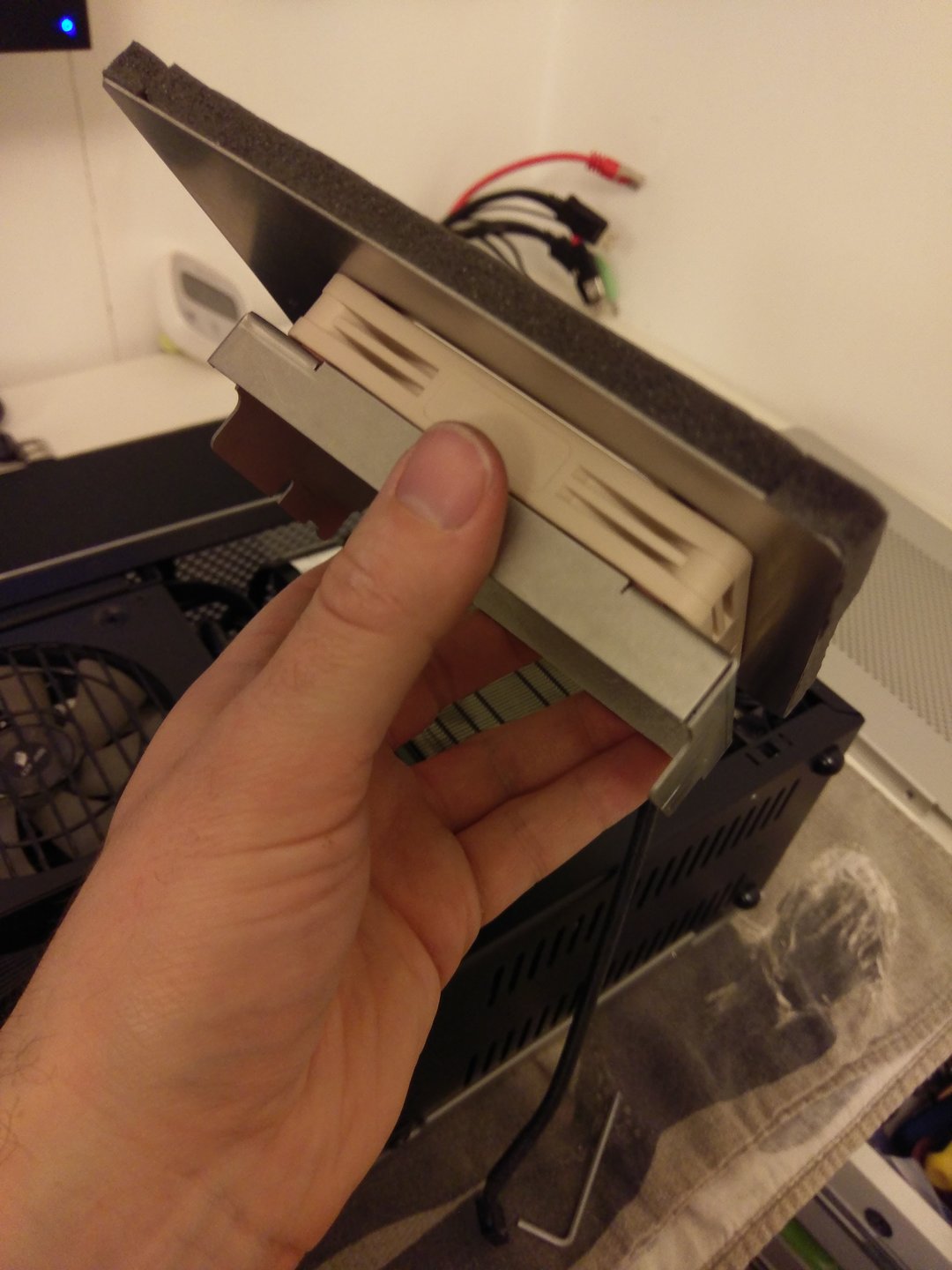

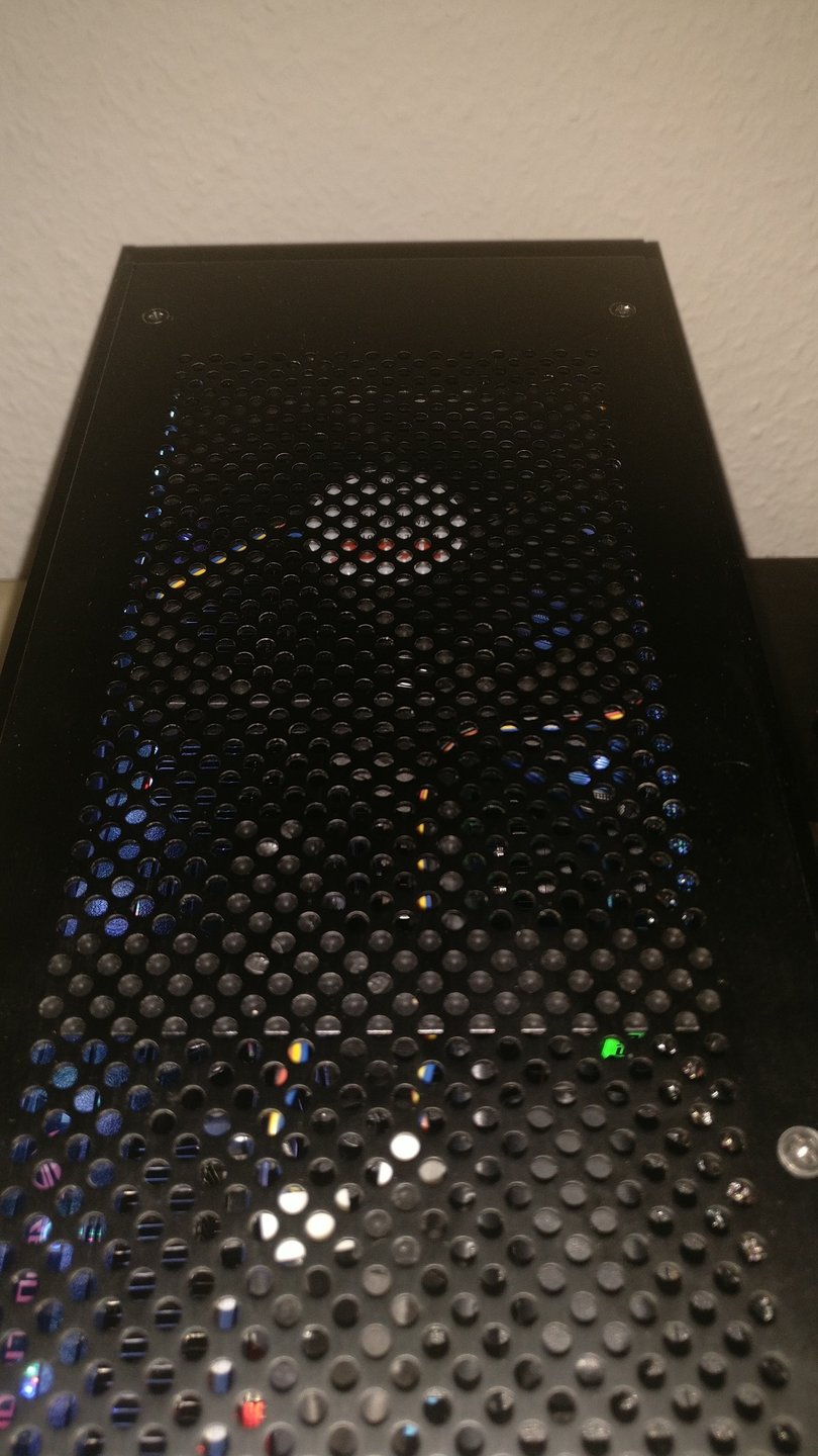

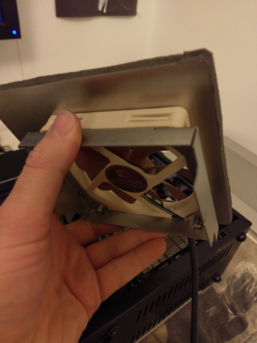

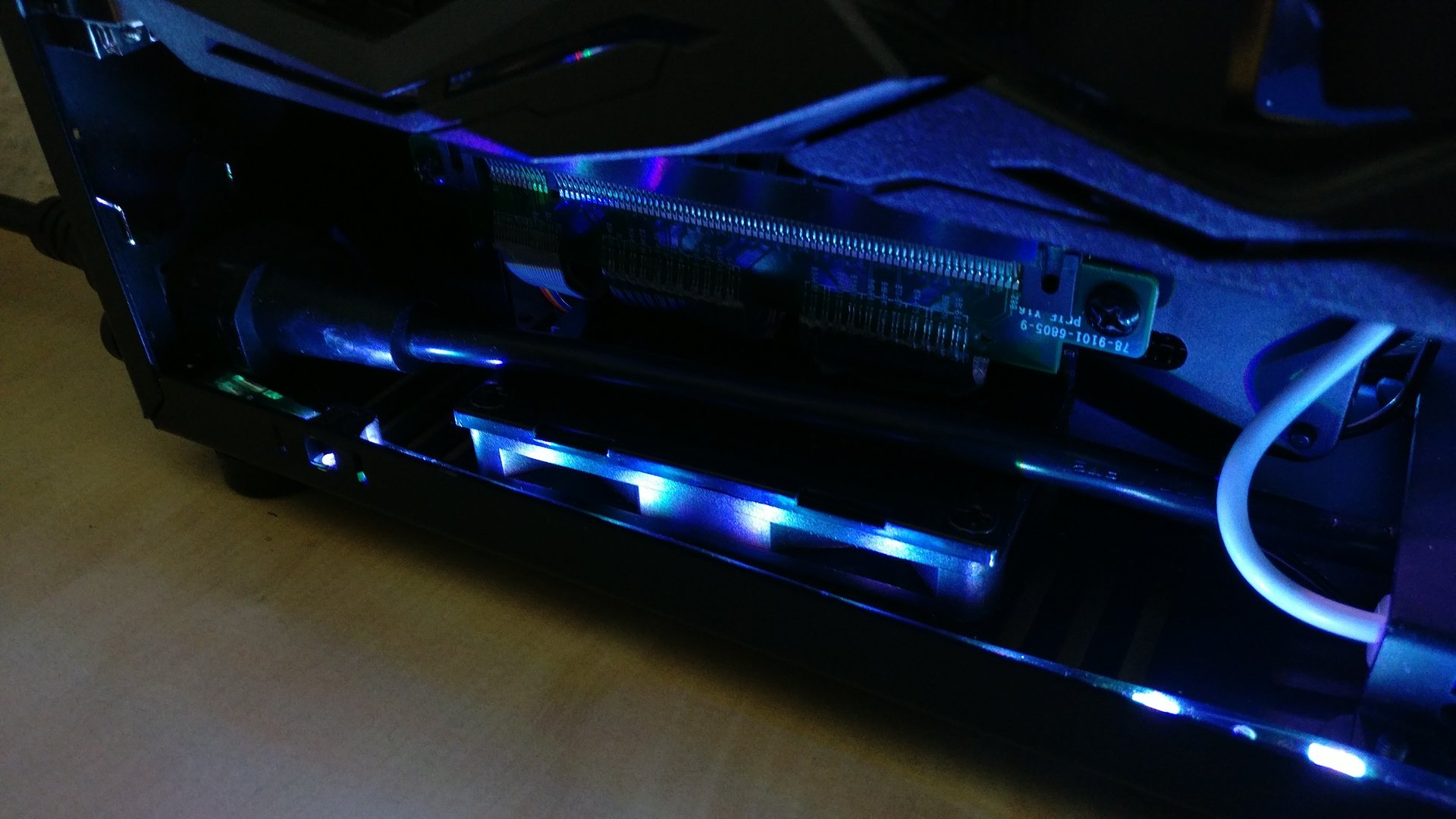

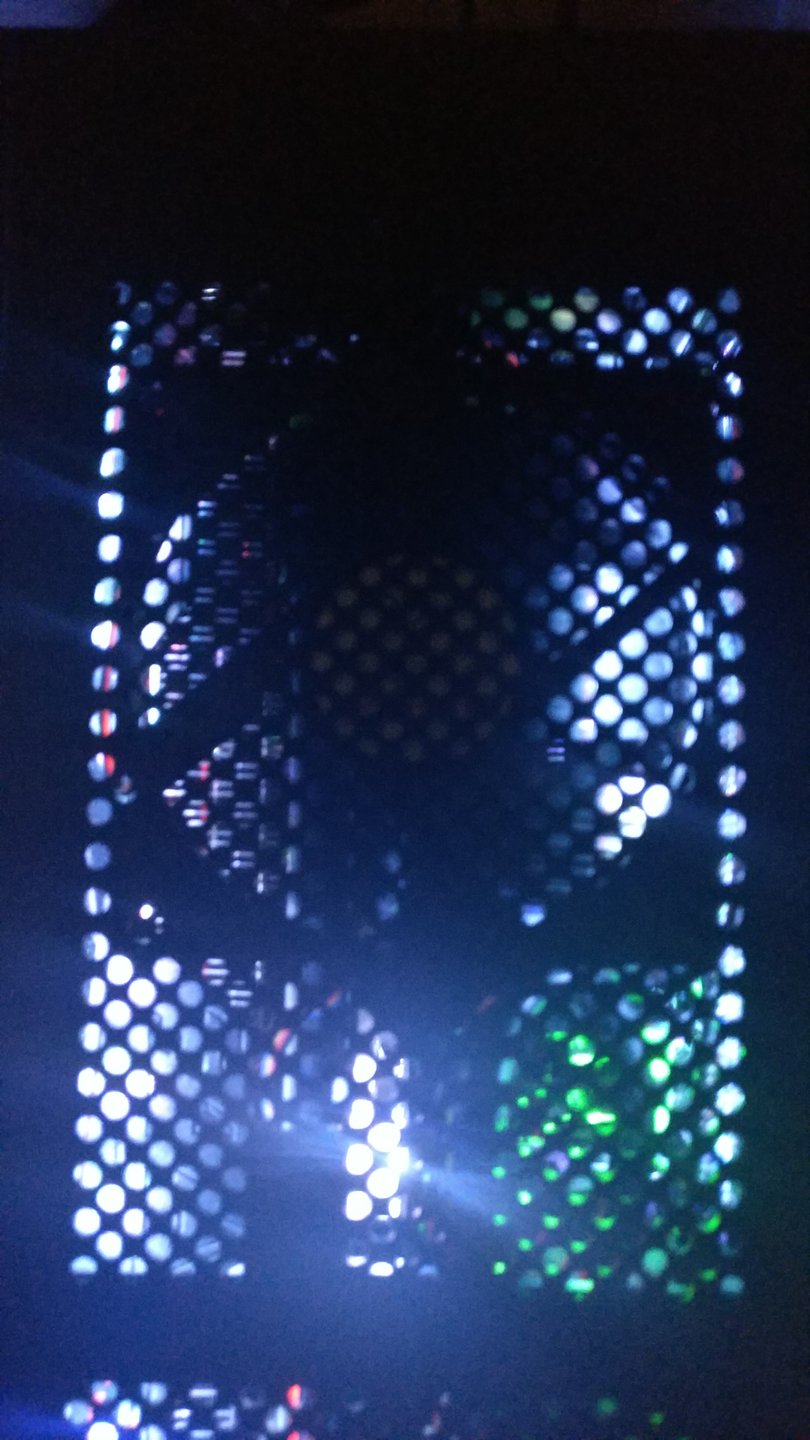

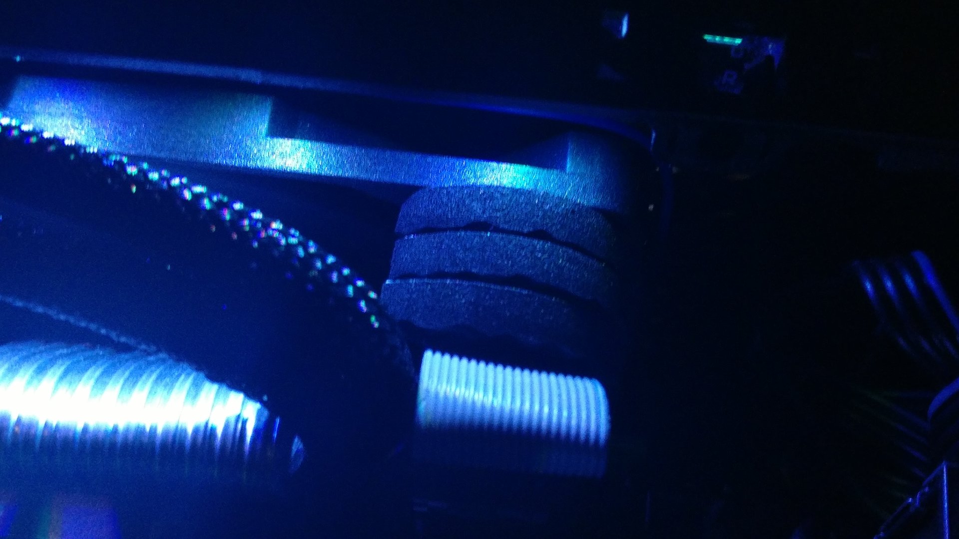

Shaav inspired me with his installation of a top case fan (here) to do the same.
And finally I managed to attach actually two(!) case fans is the A4: one in the top and one in the bottom. Both the Akasa Slim 80x10mm fans are in a push-configuration (out) to enhance the pull-effect (in) from CPU- and GPU-fans.
The fan at the bottom received a dustfilter on top because with this addition it fits perfectly jammed underneath the mainboard and can't move. So no clamps, zips or else were needed to hold it in place.
The top fan was harder to install because it always interfered with the riser card when the case front/top was installed...
So I had to be creative and put some pads at the fans case edges to push the riser down. This did the trick.
Both fans are y-connected and run smoothly between 1100 and 1700rpm depending on CPU temperature.
With delidding, undervolting and the two fans I can now slightly overclock my 7700K to 4.5 GHz and even in Prime95 I stay beneath 80°C (79-76-76-78).
Plus the GPU temperature dropped 2-3°C while gaming with the fans installed.

For those of you who plan to install a case fan in the top, I can give you the the following advices:
- the 80x10mm fan has to be pressed against the case to have enough clearance between the fan and the PCIe-Rizer.
I made two pillars made of cardboard on which the edges of the fan case can stand and put them between the GPU and mainboard tray.
- use some zip ties to bend the pcie-rizer even more.
Here are some picture of this modification:
https://imgur.com/a/7cs5a
View attachment 44224 View attachment 44225
