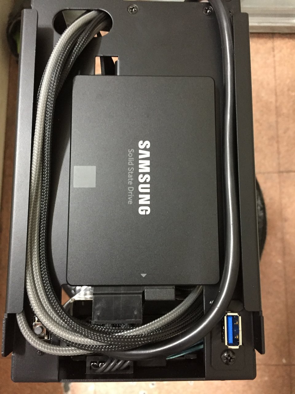

My build on this awesome case!
Specs and build log:
http://www.disfrutadelcastigo.com/2017/05/pc-gamer-2017.html
Cheers!
