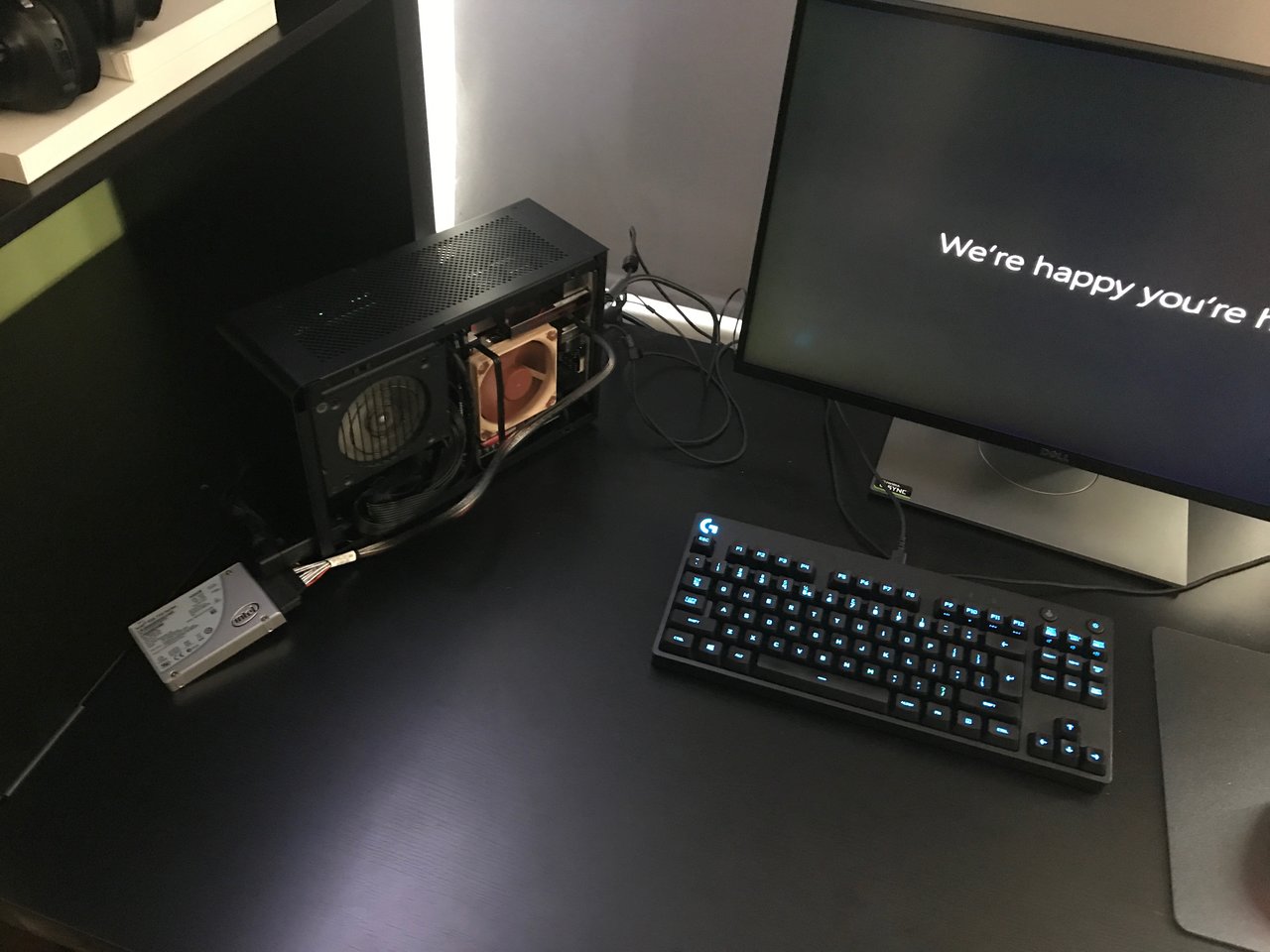

Will install an 400GB Intel 750 MVNe SSD tonight, I'll post some pictures when completed - I don't think I'll have any issues.
This Intel 750 is double the height of a normal 2,5" SSD. It connects to a U.2 connector on my Asus Z170 Maximus VIII Impact. U.2 is comparable with M.2, except that the SSD connects via a cable instead of a slot on the motherboard.
