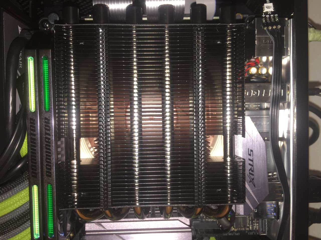

Hey, iilram. Can you please post your system specs and idle/max temps? IIRC from reading the thread, you're on a 7700k with LP53+A4, but what temps? I assume you delidded, what thermal paste did you use on both?
i7-7700K, LP53 w/ Noctua A9x14 slim 92mm fan, Team Vulcan 16GB 3000MHz RAM, GTX 1080Ti. I didn't delid, actually, but I recognize from the data that is probably one of the the best ways to drastically reduce your temps. I used NH-1 and then tried Thermal Grizzly Kryonaut, but I can't say with certainty the Thermal Grizzly did anything more than the NH-1.
I did a lot of different tests that are posted in various places, here are the most relevant ones. All temps are from HWINFO, which registers a few degrees higher than AI Suite's temp for some reason:
Prime95 26.6 (running settings in the spreadsheet floating around):
@1.14v 89c
@1.24v 95c
I hit 86c according to AI Suite also, and at 1.20v, but I am disregarding that now as it seems AI suite consistently measures lower than HWINFO. All of these are between 23-25c ambient. (This is all in the spreadsheet).
Idle varies. If I run the fan at around 1300-1600 RPM ("Turbo" in AI Suite), I can keep my idle in the low to mid 30's. If I run in "silent" mode (300 RPM) I get up to the low to mid 40's. Just browsing the internet or writing in Word, I see it fluctuate from 40's to 60's. "Turbo" mode is still very quiet with the Noctua. The a9x14 is really an excellent fan.
In AIDA64 I get high 80's, low 90's depending on ambient. In gaming I see low 80's high 70's.
There are a few things I recommend whether or not you delid and whether or not you get the LP53.
1. I saw a very big difference in temps when I removed the IO panel and removed the oversized VRM heatsinks on the Asus Strix motherboard that were impeding airflow. You want to make sure the LP53, or any low profile fan, has at least one direction in which air can flow more or less unimpeded out of the case.
2. Undervolting your CPU just a tad results in lower max and idle temps. I was able to do a negative offset of -.080v and saw a 6c or more reduction in load temps, while maintaining all my stock clocks. This was almost as significant a jump as I saw when removing the VRM heatsink. "Out of the box" you have some free voltage to play with, basically. No reason to keep it there.
All of the above goes out the window if you just buy a lower wattage chip. (But where's the fun in that?!!??)

Here It is, the 22 core Xeon e5-2696 build.
Thermals with the case closed and fully loaded while rendering a very complex 4k scene in vray of my own (ambient temp 23ºC):
· E5-2696 22Cores 2,2 Ghz base + Dynatron-318 + Thermal Grizzly Kryonaut + TY100 fan at 100% speed = 82ºC
· i7 5820k 6 Cores 3,3 Ghz base + Dynatron-318 + Thermal Grizzly Kryonaut + TY100 fan at 100% speed = 67ºC
I've used a 100% fan speed profile for these tests. For normal using I set a profile like this: 50º 45% 60º 60% 75º 100% 80º 100%. Most of the time it is barely audible, my current temp while writing this post is 50ºC with 45% fan speed.
I also have the Cooljag Falcon II but I went with the dynatron as it mounts more sercurely (there isn't a native 2011-3 narrow bracket for the cooljag) and it performs just the same in my testings. The only benefit of the Cooljag is that it is more silent as the fan is behind it.
Next week I hope I'll receive Grizzly Conductonaut Liquid Metal. I'll post the results.
