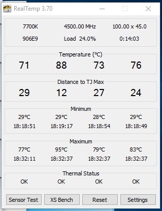

I understand that it is normal for 1 core to run hotter than the rest but I am getting up to 16degree difference. Any advice???
What cooler are you using? If it doesn't have known issues, then it's time to reseat the cooler. If that doesn't work, you either can decide to live with the issue or delid your processor.
I also have 15degree between two cores - both in my ncase with h100 and now in dancase with lp53+a9x14 - 4790k. :) will soon order deliddiemate2 and clu

What makes the Dan Case so special to me, is that each fan operates at the same time as intake fan, cooling fan and exhaust fan. The suction side of the fan is it's intake function, the pressure side is it's cooling and exhaust function. To make this work, you have to strictly separate the suction side from the pressure side. Otherwise, a certain amount of hot air will be recycled through the heatsink. Again, quite simple.
Here is, what I did: Create a small duct for the CPU fan, which separates the suction side from the pressure side. A cardboard strip (cereal box in my case) of 20mm width, is enough for the NH-L9i.
[/URL][/IMG]
Here is what I gained:
Granted: Delidding the 6700K brought down the temps by 17° (delta from 67° to 50°), but the fan duct reduced it by another 6° (delta from 50° to 44°).
I created my custom fan curve in SpeedFan (I could do the same in BIOS actually), which settles the fan speed @ 1800RPM creating a delta of 51°. Which to me is quite bearable, acousticly as well as thermally. It is not as silent as my R5 of course, but good enough to trade 48 liters of volume (the R5 is lovely, but big).
So there you go: It is probably the cheapest and easiest mod. It is certainly not beautiful, but it brings down your temps by 6° or it relaxes your fan speeds at equal temps.
