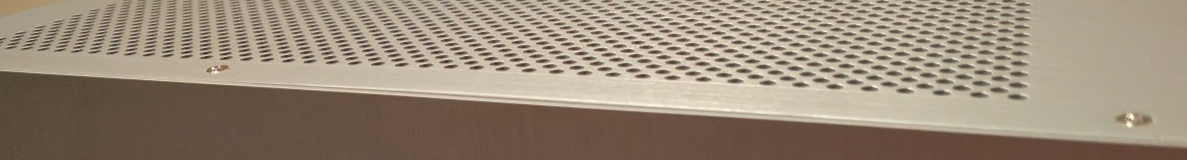

Anyone else have issues with the top panel slightly bulging out between the two screw points?
phoxx
Jun 6, 2016
36
This is not an issue really, considering how thin the aluminum is and with only 2 screws on each side to hold it down.
If its really bothering you, just take off the top/front and slightly bend that area in by hand.
I was able to fix it, thanks.
