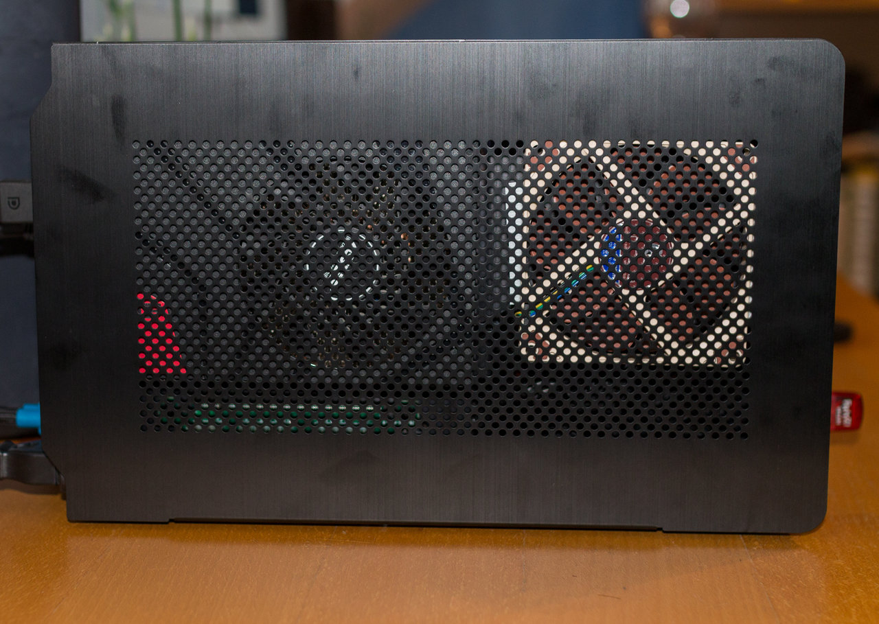

So I did something for fun:
A DAN A4-SFX AIO build :)
And it was not that much fun fitting all the cables... I really need to order som custom length cables :)
Anyway:
Z270I MSI Gaming Pro Carbon AC
Intel Core i7 7700K (delid)
Corsair H60 AIO with a Deepcool Gamer Storm GS120 fan (I somehow thought I would fit a 25 mm fan, but that was not the case)
32 GB Corsair VENGEANCE LPX DDR4
Gigabyte 1070 Mini ITX OC 8G
Corsair SF600
Part list / Build log.
Some test results here.

Corsair H60 AIO with Scythe Slip Stream 120 mm fan (I somehow thought I would fit a 25 mm fan, but that was not the case)
Corsair SF600
I haven´t tested it properly yet, but I assume it will be a grand failure :) Since the radiator doesn't really have anywhere to get rid of the hot air. It pushes it against the cables and the PSU.
So I will try to optimise regarding the cable length (maybe move some of it down under the GPU?). The CPU is also going to receive a delid as soon as I receive my kit. I also have a 92 mm AIO lying around so I might try to do the AIO below the PSU theory.
try putting the fan behind the radiator so that you get less turbulence and make it shoot the air outside? why do you say that the radiator can't get rid of the heat? that is pretty great!
i like that build , but whats the matter of water cooling if other parts are louder ? like the gpu ? that gigabyte must be pretty loud with that single fan ?!
You have a point :) (I just did this build to see if it is possible). I haven´t used the GPU for that long, so I don´t know how loud it will get, but right now it doesn't seem that much louder than my other GTX 1070 (EVGA).
Thought about that, but then the fan would be squeezed between PSU, cables and the radiator. I don´t really think there would be enough air around it, for the fan to push it through the radiator. The fan would be starved for air.

DAN A4-SFX AIO build v 0.2.2:
So I did as suggested and flipped the PSU around. The plastic separator problem was elegantly solved by folding it together and pushing it behind the GPU :) I also redid all the cables.
Used more individually sleeved cables and rerouted more of them into the GPU and Radiator chamber. There are now slight openings the whole way trough to the other side so you can now feel a slight breeze going through the case. The 24-pin ATX connector is still the old ugly one. So here I will need to get a shorter and sleeved cable. The improved cable routing also led to a better routing of the AIO tubing with less kinks and less "bubbly" sounds afterwards :)

3 hours with running these benchmarks: CPU never got over 74° C and GPU never over 75° C.
  • Aida64 stress test (CPU, Memory & GPU) for 2 hours > CPU max 72° C and GPU max 71° C.
  • Prime95 (28.10) stress test (CPU) for 30 min > CPU max 73° C.
  • Timespy stress test: 98.7% > Temperatures GPU Max 75° C and CPU Max 70° C.
  • Superposition stress test: passed > Temperatures GPU Max 70° C and CPU Max 59° C.
Sound:
30-35 dB when under really heavy loads.
