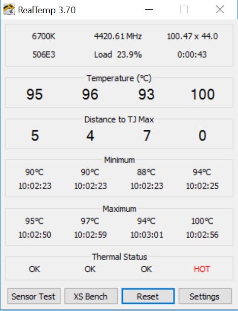

Just got My ar05, but first, these are the temps for the Cryorig C7:
Idle:
Stress test with Prime 95:
Not bad, but the noise obviously is annoying at full fan speed.
Now for the SilverStone AR05, here is a video:
Idle speed: 1124 RPM
Full speed: 2320 RPM
Very very quiet at full speed, which is great! But these are the temps with a 6700k @ 4.4Ghz:
Idle:
Ouch, within the first minute it hit 100°C, I wouldn't recommend the SilverStone AR05 cooler if you are planning to overclock, but if you aren't looking to overclock its very very quiet at 100% fan speed (86°C max @ stock speeds).
This weekend i will try the lp53 with the a9x14 and post a video and some temps, i'm also waiting on a nexus to come sometime soon, i will do the same for that if i can fit it in.
