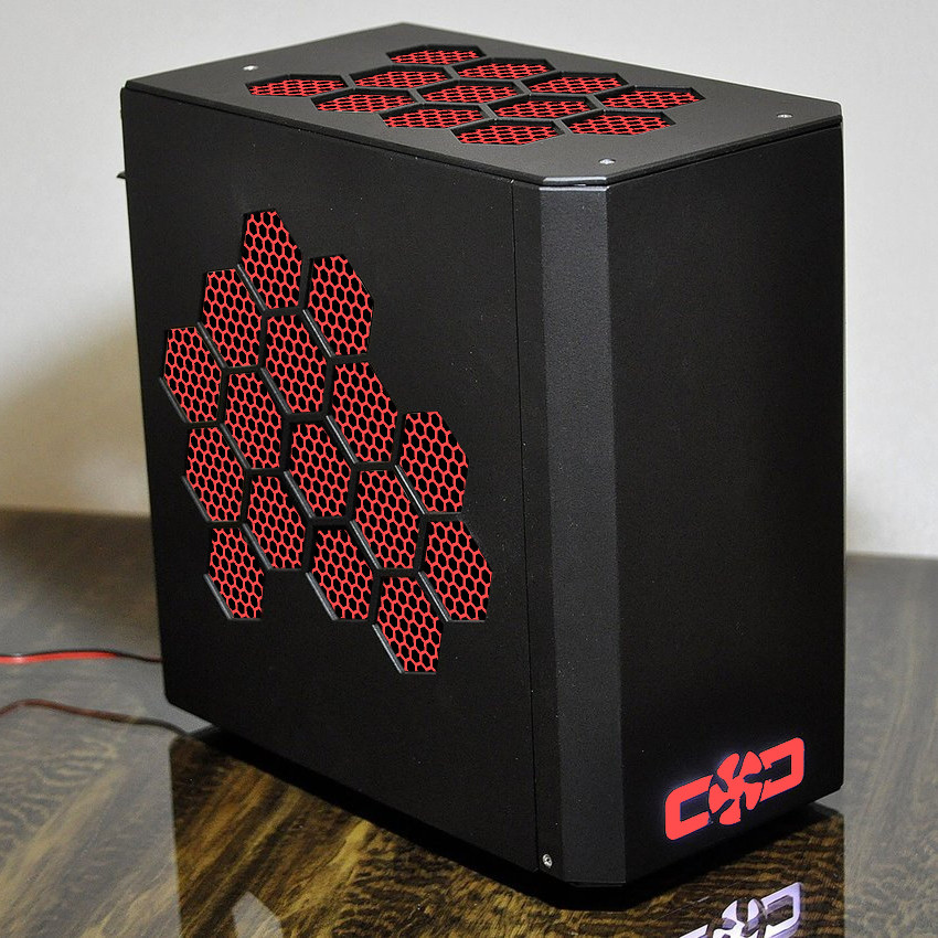

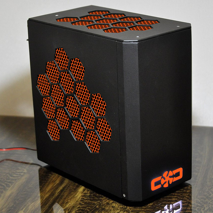

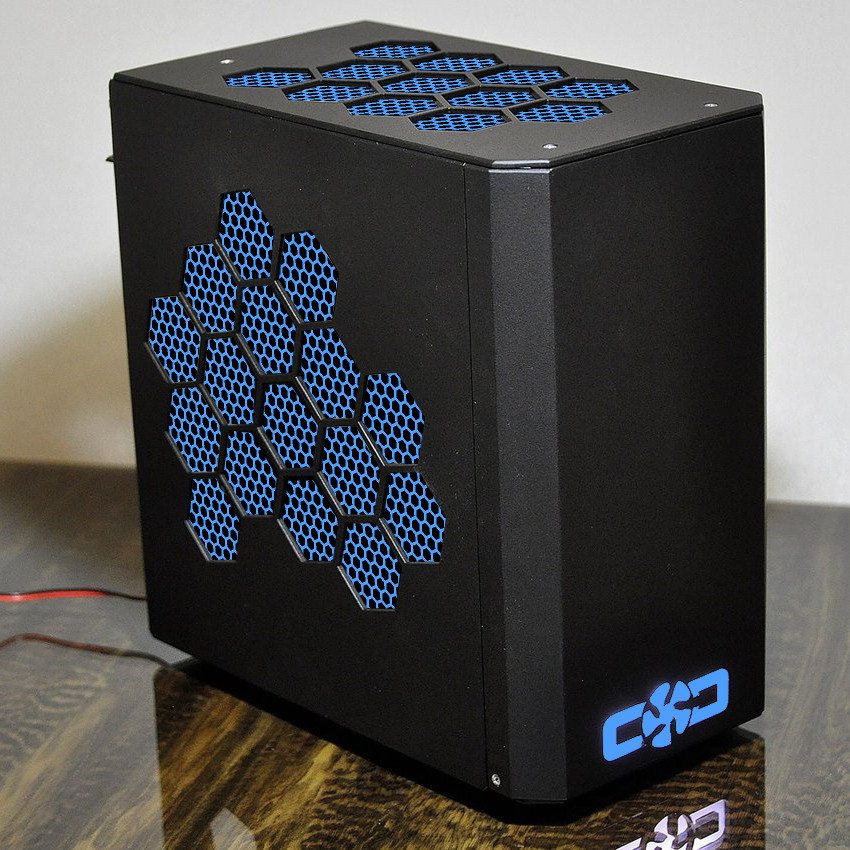

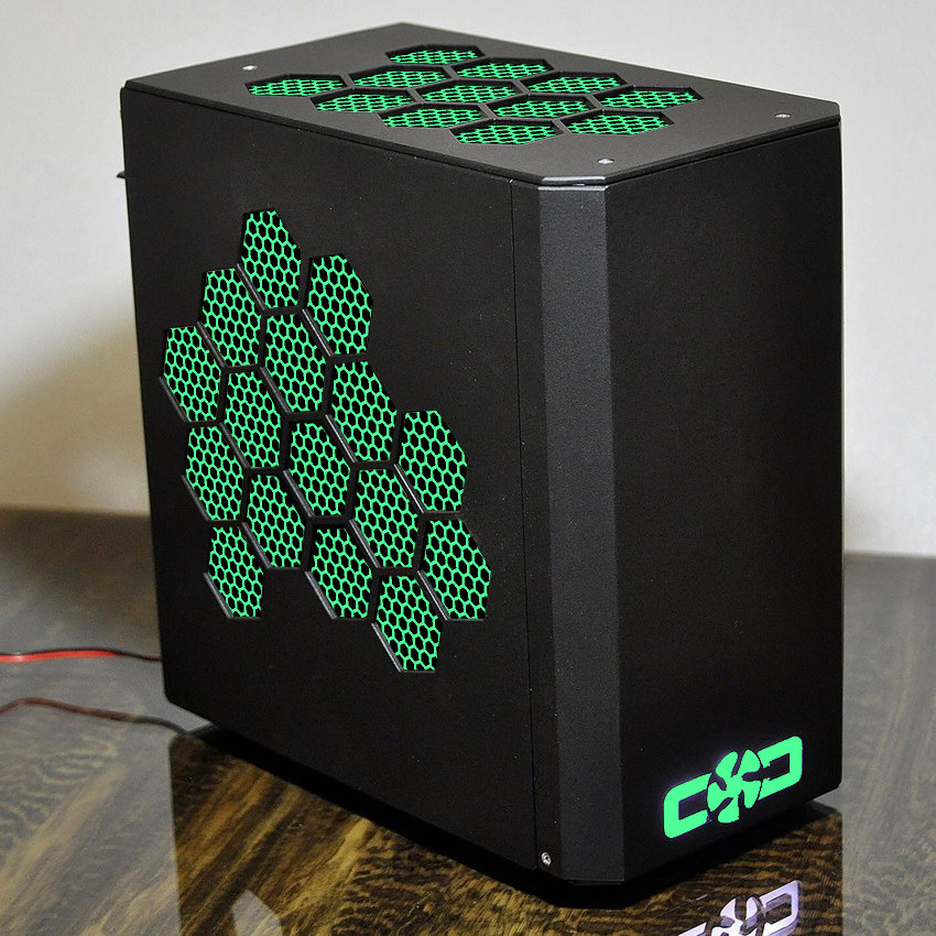

My concepts for this - just get some kind of bright coloured honeycomb mesh and add the same colour backlight to the front detail:
I'm not interested in buying, I'm just dropping the idea on how you could customise this for your clients without redesigning the laser cutouts while also fixing the problem of those huge vent holes where you can put your finger through them and touch the inside (you won't be able to put CE mark on this now).
