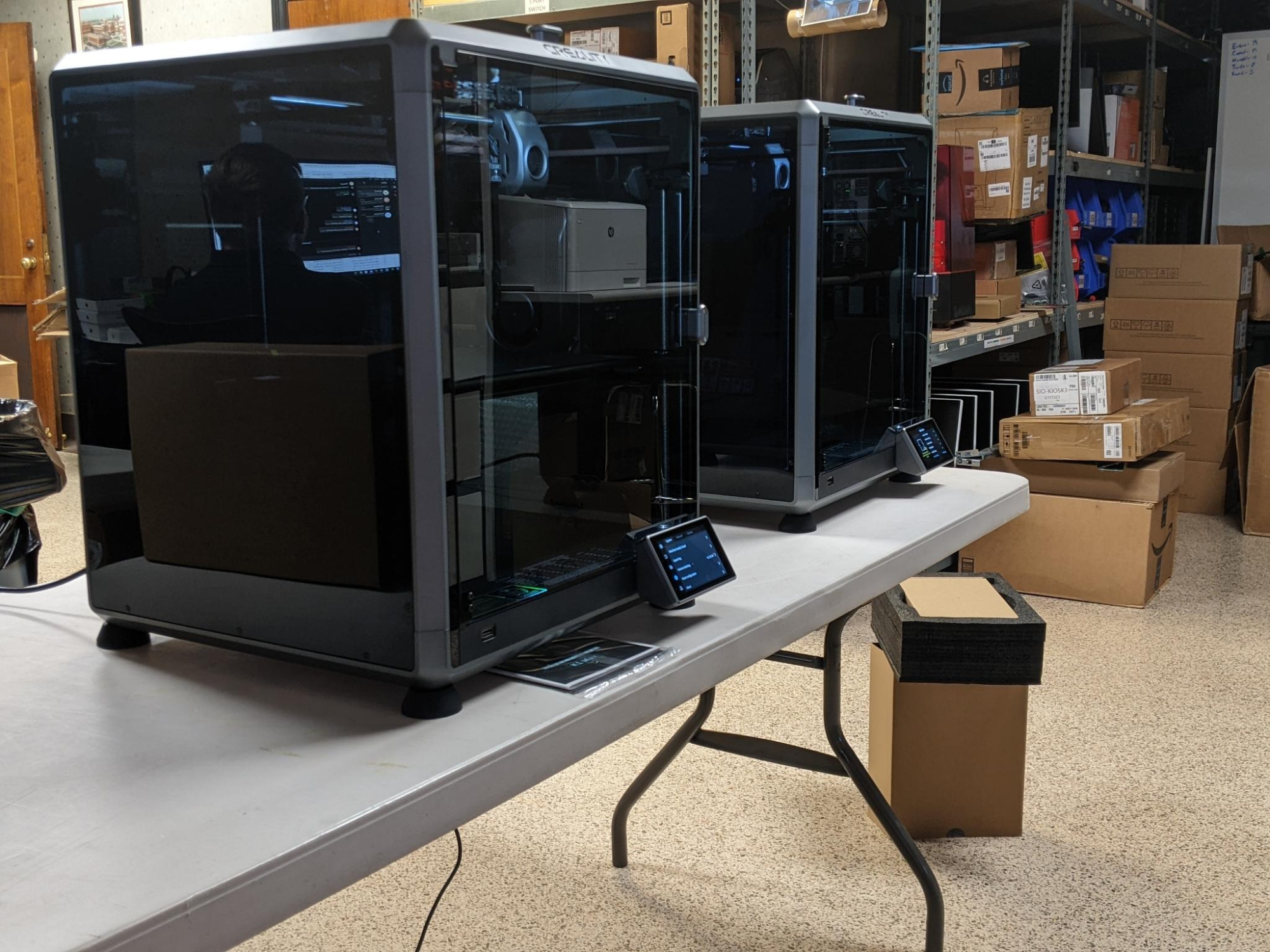

Me and a coworker picked up some K1 Maxs. Its everything ive wanted in a printer. They took all the upgrades i would do to a printer and applied them out of the box. Printer straight up gets down.
I rooted mine and flashed open source klipper over top and fixed the input shaper. Just need to figure out why the camera isnt showing up in fluidd and mainsail. Otherwise its been great. Only mods i plan to print for mine is the top glass spacer and maybe the 270 degree front door hinges. Might stick an aftermarket drop in hot end in it for increased flow and top it off with a ruby tipped nozzle and just leave it be and print.
We paid $683.05 delivered for them.

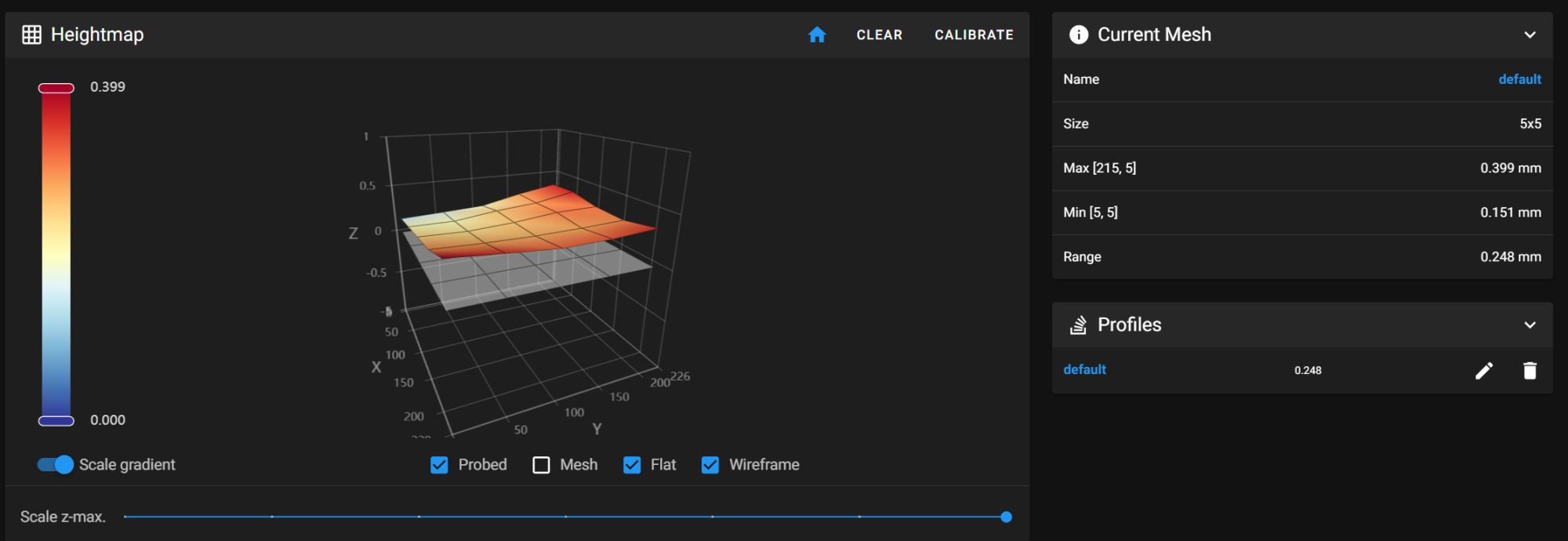

Used the GitHub repo linked a couple posts up to do the listed tweaks and macro changes, along with installing moonsail because I prefer that over whatever limited web panel it was running stock.
After that I did take the time to get the bed as level as I could, because out of the box it was skewed 1.5mm across the plate. Kind of a pain with belt synchronized lead screws but it was worth the effort. Creality claims its auto bed leveling can deal with up to 3mm variations but I would never accept that as gospel.
