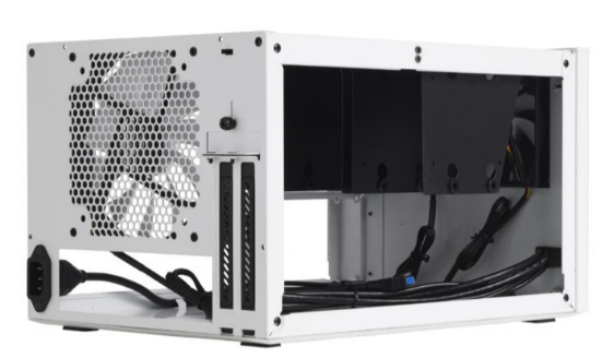

My case is a Fractal Design Node 202 Mini-Itx Case and I have a Gigabyte Vision D Z590i mobo. To save money I was using the case ram and PSU from my last setup. However it alwasy ends up costing more than you plan .:LOL:

I like Fractal's cases but the Node 202 is probably the worst Fractal case you could put a powerhouse system in. Way too often people want an ITX build as small as they can get and then have trouble with very high CPU and/or GPU temps. In my experience one is okay and the other is extremely high depending on configuration and airflow, but some setups are so powerful and the case so inadequate that both temps are way higher than they should be.
If you want my honest opinion, you need a different case but you can stick with ITX. I had the Node 304 and I loved it. It's much bigger, but still technically SFF at just over 19L. It can fit a full-sized CPU cooler up to 165mm, and airflow is quite good for an ITX case with little mesh. My first ITX build was in the Node 304 with an i5-6500 and Cryorig M9i cooler and my CPU temps were in the low 70s maximum. GPU got into the 80s running hard, still very acceptable for a SFF system. I'd highly recommend you check it out, because that 202 isn't going to do you any favors for a performance build. Those ultra-slim cases are best for HTPCs that don't get used for much beyond media viewing, web surfing, and maybe some modest gaming.
Yes I really like the Fractal Design cases. I was looking at the Torrent Nano although I wouldn't want a glass side panel and the colored fans. My workaround for now is to use Lasso to reduce the number of cores available to Blender, so reducing performance a little but keeping the heat manageable.
The Torrent Nano is a pretty good case, although it's fairly large for an ITX case. (For its size, I was disappointed it did not offer mATX support.) Fractal has an option for the Nano without RGB fans and with a metal side panel and it actually will save you a few bucks. It can fit a full sized CPU cooler up to 165mm, and the 180mm fan can be switched out to two 140s for slightly boosted intake.
If you are okay with that then the Torrent Nano is an excellent choice. If you want something SFF still then go with the Node 304.
