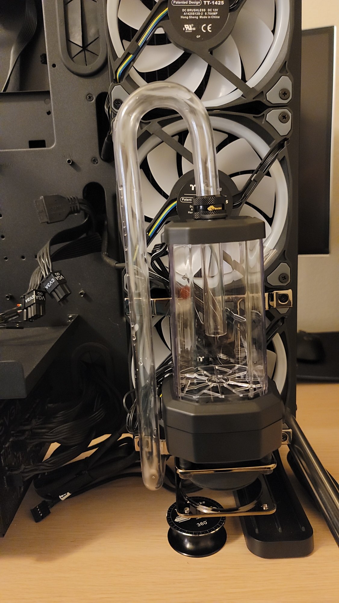

Starting my build out , will be a 5900x with a 3080 or 6800xt

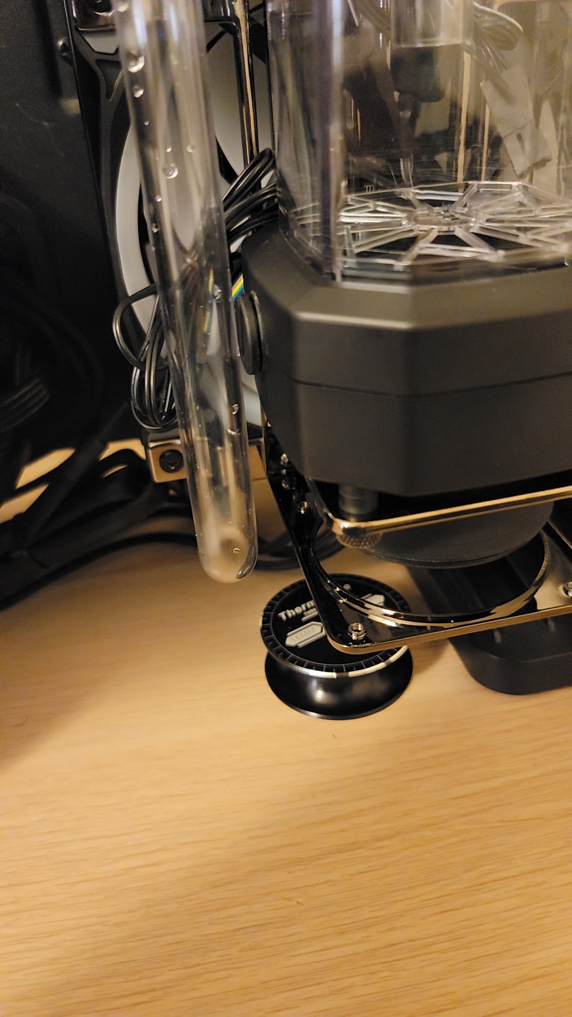

One snafu so far, the first piece of tube slightly touches the plug on the side of the pump which pushes the tube slightly making it look crooked. going to keep it for now, will reroute it once all components are in and I have a better idea of clearances.

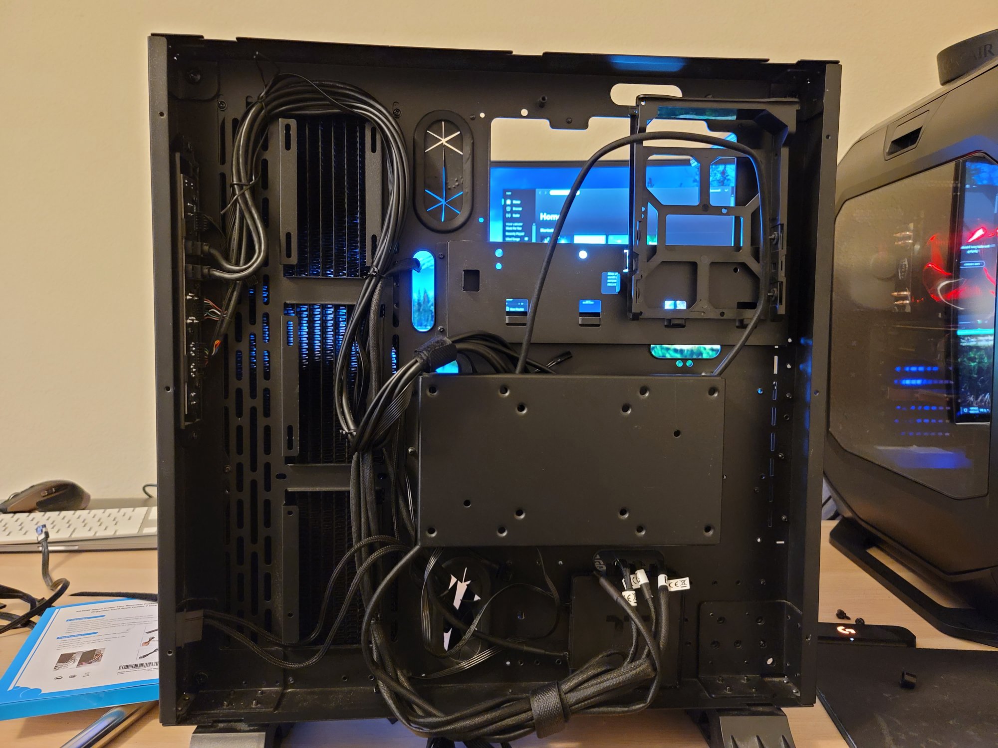

Switched up some stuff, went with corsair fans to stay in the same ecosystem for lighting control, lets me avoid Asus Armory Crate (shudder)

Also I destroyed my x-flow rad, trying to install some counter sink plugs to mount it flush so that I can have the dust filter on the back. So I switched to a U-flow v2 from alphacool which has flush plugs available.
