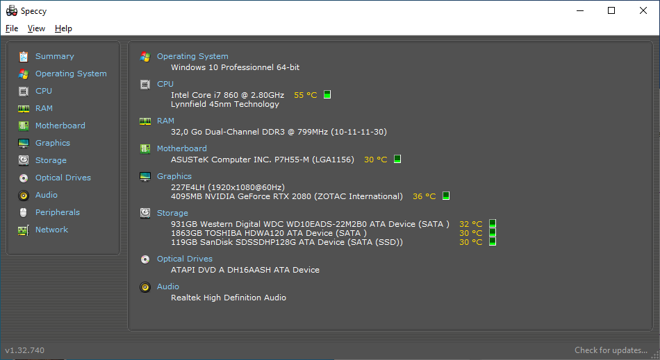

Hello rrx,
I have a core i7 860 too with ASUS P7H55-M Motherboard : I would like to put 32 GB of RAM too.
Does Windows recognize all the 32GB of RAM, really ? May you share some screenshots with the app "Speecy" ?
Thanks
bye

I know certain 1366 boards suggest limitations on capacity (DIMM size is mostly what it comes down to, limited 8gb DIMMS to put on the QVL) that dont seem to exist in reality, my gut would tell me that if the board supports 2X8gb, theres no reason it wont support 4X8gb. YMMV.
