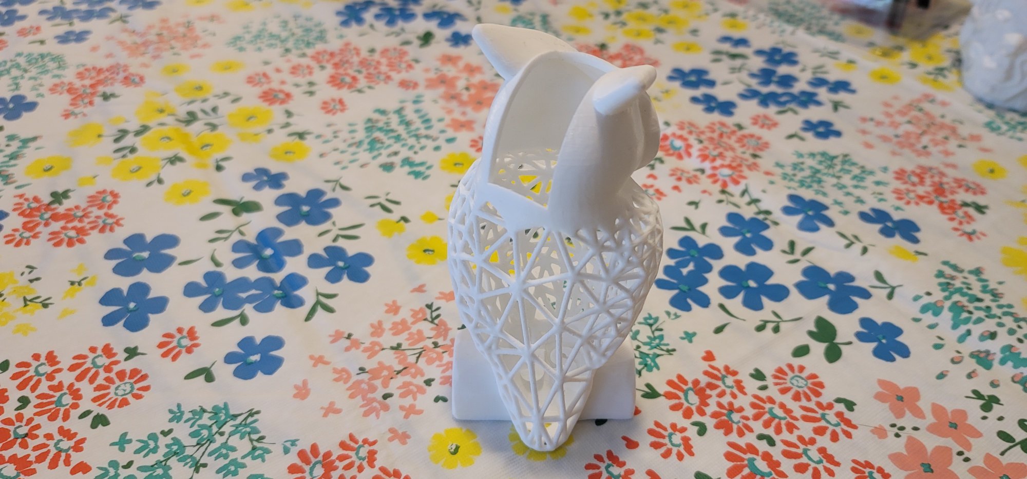

Looks like you got it all properly setup for your initial prints.
Yup 😁
Now for the hard/fun part. Learning to make my own stuff. 🤓
