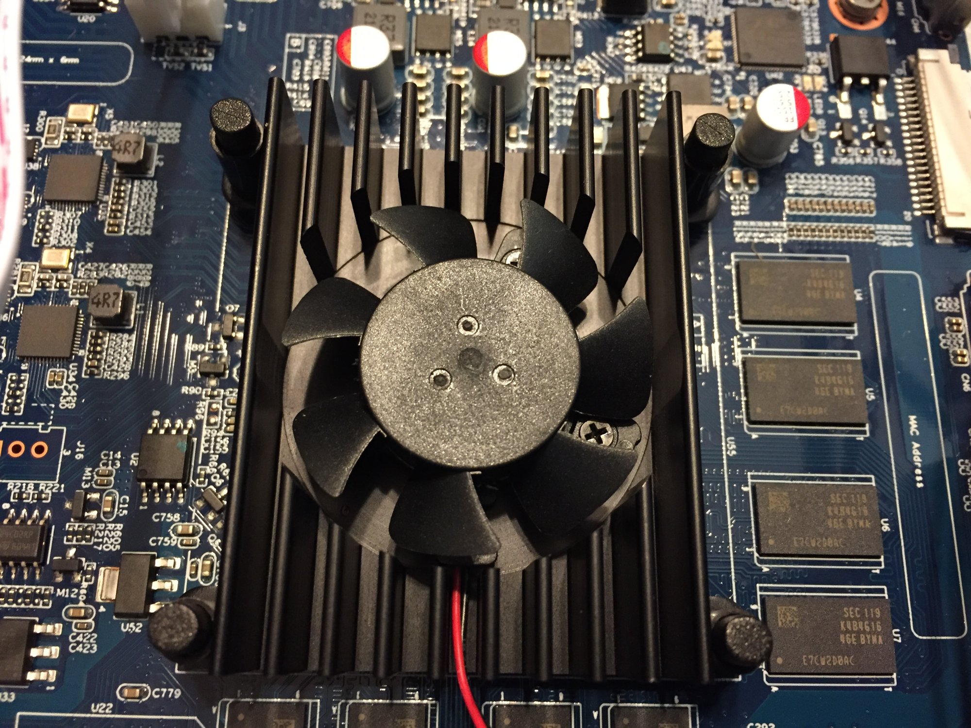

The fan on the motherboard looks like a standard 37mm fan. They aren't really made by DIY companies like Noctua though, but you can get generic ones if the fan is failing. There are other sizes of this fan, but it looks to be 37mm.
https://www.ebay.com/itm/182164276128
The fan is attached to the heatsink with 3 screws under the fan blades, you can see two of them poking through in the picture in the OP. If you unscrew all three, the fan should lift out and there should be a part number on the bottom to match it up or cross reference to a different fan of the same size.

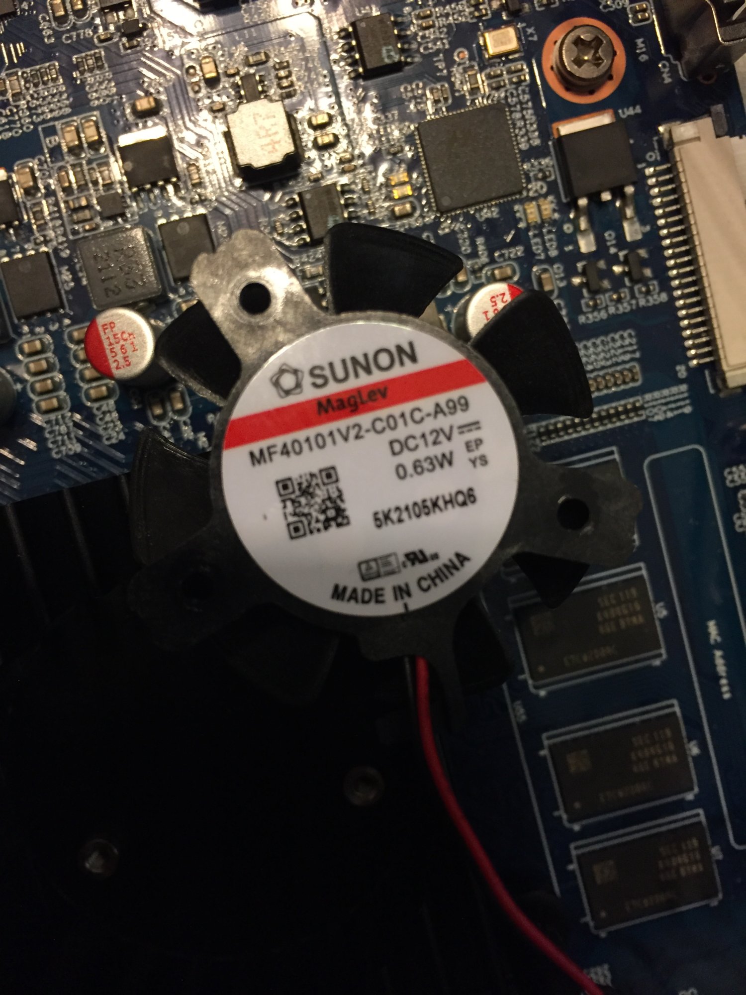

BTW, checked that MOBO fan. The label reads 12V but when you look it up, it says 5V. Also, says it measures 40mm. Not sure what to do, I dont have a meter to check the voltage. Noise is at 20.6 dB.

Yeah, looks like a custom run of the mf40101v2-1000U-a99, which is a 40mm 12v fan (but has a full shroud). You'll probably have to get it from whoever made the heatsink, or from some supplier in China.
Alternatively, you could cut/break some of the fins and put a square fan with some spacers to lift it up a bit or cut slots in the frame, or cut the whole frame out and tape/glue the fan down.
Sunon has a ridiculous number of variations of fans, sometimes with almost identical part numbers. It's common for them to have a fan design with multiple models that run at different voltages. I'm sure there's one like that which runs on 5v, but that one is probably 12v like it states on the label. If you need a cheap multimeter, you can get one at Walmart for $20.

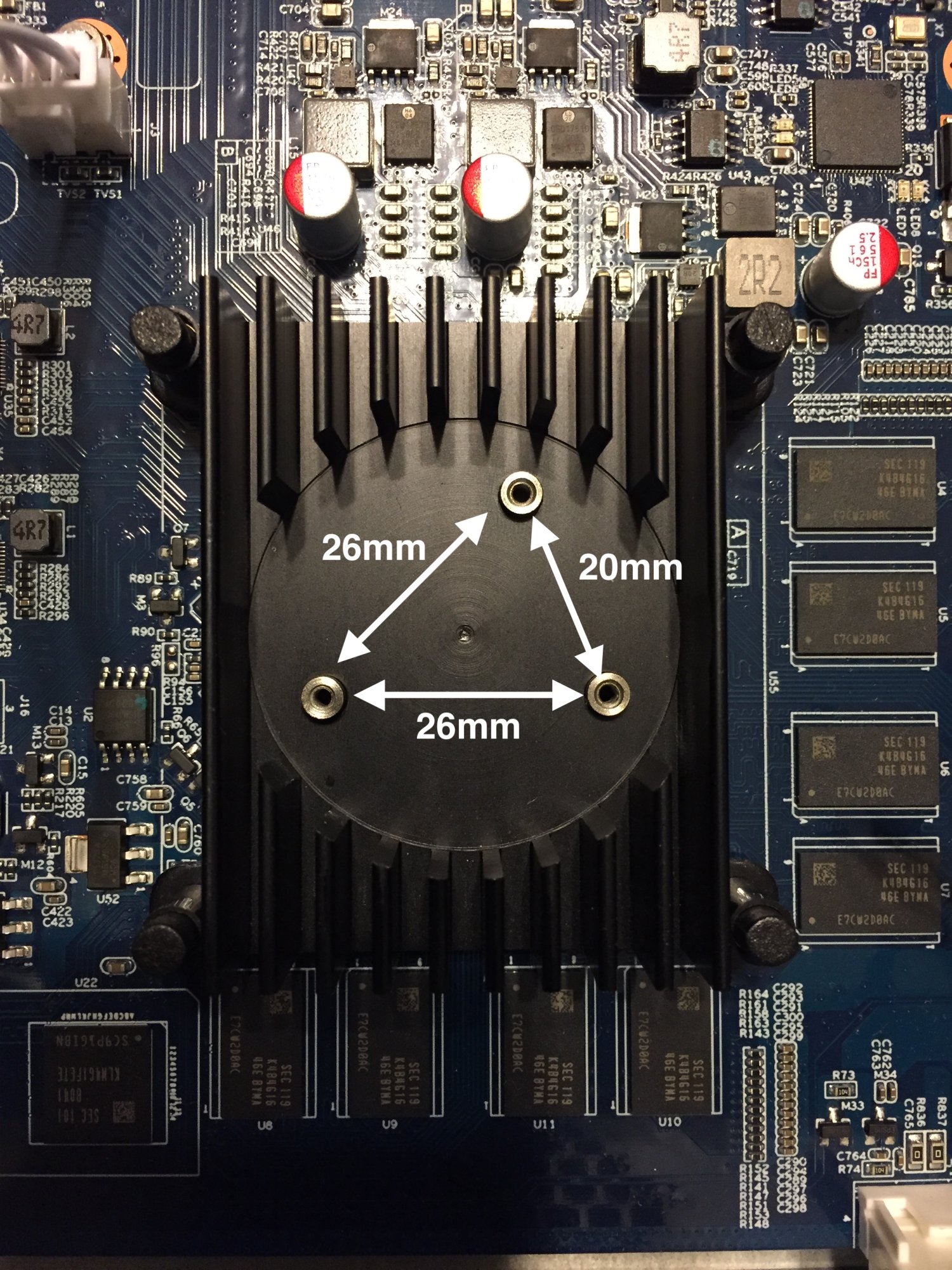

Hey guys, wanted to post a follow-up. GiGaBiTe, that fan would have been perfect but I didn't realize the original fan had a weird pitch.
The SUNON MF40101V2-C01C-A99 37MM 12v has a pitch of 20mm-26mm-26mm. I couldn't find anything that has the same pitch. Before I throw in the towel, just wanted to reach out one last time.

The pitch is probably referring to the Y tab length on the bottom of the fan, these are usually pretty standard. But you can get the exact same fan on Amazon:
Yes, the space between the tabs is the pitch, the spacing between the tabs is not the same.
