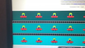

DyAc: So this is the entire reason I bought this display, to have BFI that doesn't lose brightness when turned on. I can confirm that this monitor does not lose any brightness with DyAC enabled unlike every other competing display which tend to cut their brightness in half with BFI enabled. I briefly read about changing the vertical totals on these forums and since I likely won't hit 240 FPS even with a 9900k@5 Ghz and 2080 Ti in the games I play (Warzone/Apex Legends), I settled on 182 Hz with VT of 1350. I tested many different vertical total values out and 1350 just seemed to work best as the top/bottom of the screen had minimal blurring and the middle was great. I'm not sure if I captured this correctly using my iPhone X but this is the best I could do:
Image of the 3 UFO strip taken from the raw video (youtube caused a lot of compression artifacts):
