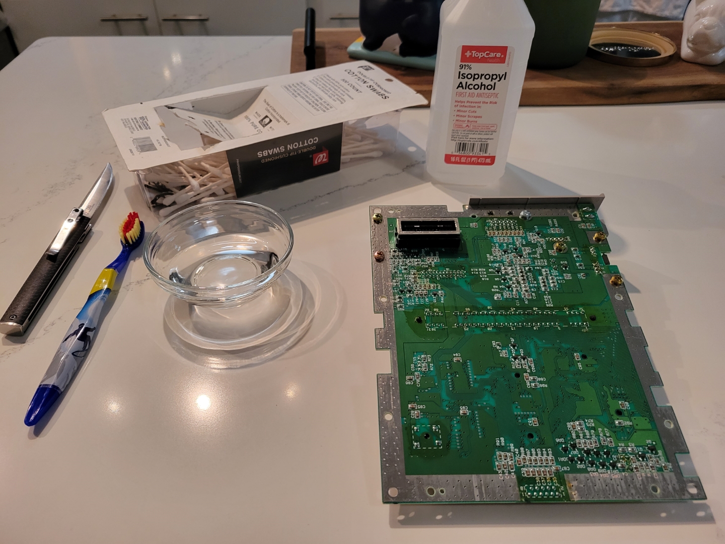

Also in the plan for this console is a good cleaning with Isopropyl Alcohol and a children's toothbrush on all of the electrical components.

Prep/Assembly: (Isopropyl + an awesome children's toothbrush with snowboarders on it), just to give everything a super clean wipe down:
