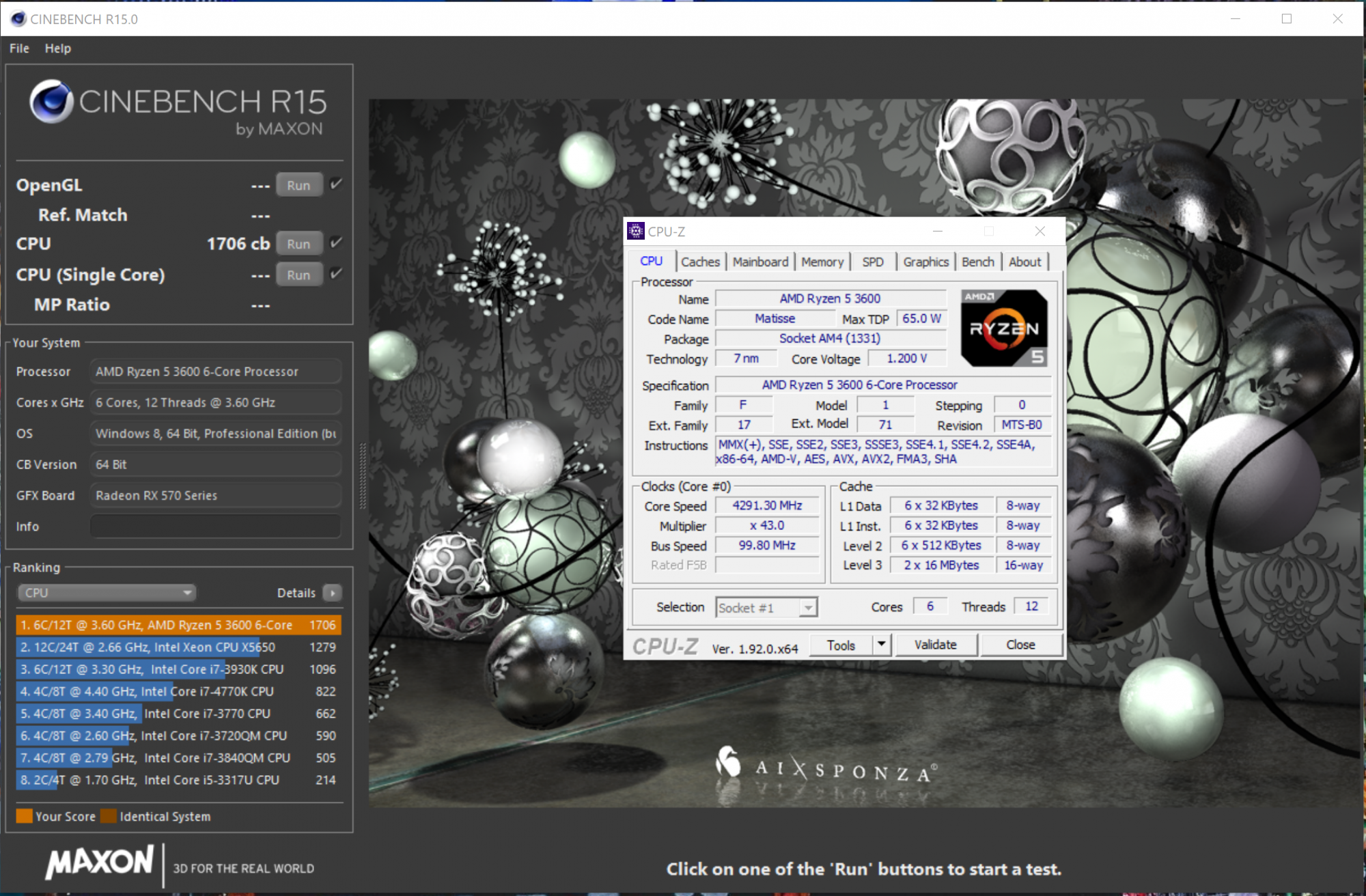

Update: followed this guide posted on another thread. The results are precisely what I was hoping for! No problems so far...
Stock: temps up to 93C
New: temps up to 73C, 6C/12T stable, boosting up to 4.4 Ghz. Temps up to 64C, 6C/6T stable at 4.475 Ghz.
Wow. And my CB20 score is up 500+ pts from stock at 3996.
As always at HardForum, I'm satisfied with my care. Thanks to all..

I think I finally figured out how to accurately achieve maximum FIT voltage, as there are many outdated threads and opinions. I enabled PBO. I used HWiNFO64, watched the sensor on SVI2 TFN on it, watched the voltage on Ryzen Master, and watched the voltage on CPU-z. All read pretty similar. I ran Prime95 SmallFFT. The highest voltage record on any program was 1.378, with an average of 1.369 according to HWiNFO64. So I hope I'm reading this right by thinking my max FIT is 1.378, but will set it to 1.369. Will try that and report later.
Update:
Set voltage to 1.369v and was stable at 4.5Ghz, temps up to 80C with CB20 score of 4005 after 6 passes.
So then becomes the question: Do I leave it as above or set it back to 1.3v, stable at 4.0Ghz, 73C? The latter seems tempting because lower voltage and lower temps, but from what I've read, under-volting can be bad too.
Opinions and advice are welcome! Let me know if my methodology isn't sound/I'm missing something.

Just got my 3600 setup and running and gave that guide a try, still on stock cooler but got it running 4.3Ghz at 1.2v, not bad for using the stock crappy heatsink where it loads around 80c.
I believe my FIT is 1.28v @ 4.4Ghz, so I set it there for 6C/12T as well as 4.475Ghz @ 6C/6T 1.28 voltage. My CB20 score is still 399x which is fantastic, considering I did squeeze 4005 once with my voltage set at 1.38v.
Weird thing though: ran Prime95 and I thought my FIT was going to be 1.3v, but the MOMENT one core went onto test 4, my temps jumped to high 80C and voltage went to 1.28v-1.29v and stayed there the rest of the stress test. No other synthetic or real-world test quite stresses the CPU like Prime95 in my experience, so that's the only time at these settings my temps were in high 80s. All other testing, they've maxed at 73C.

At this point, strictly Ryzen Master for OC. It kills me to no end, as I've NEVER OC'd via Windows. But for these purposes, most sources pointed me to Ryzen Master. Different times indeed. Although, now that I'm stable I'm tempted to set a profile in BIOS with these settings and call it a day. Hopefully my experience from a newb perspective will be helpful for other newbs in the future.
Thanks again to all, and to thesmokingman for sticking around and reminding me to figure out how to get FIT. I've loved HardForum for 17 years; here's to 17 more.
Grats. 1.28v range is more realistic for FIT voltage. Now that you've found you safe voltage you CAN set it in bios.
