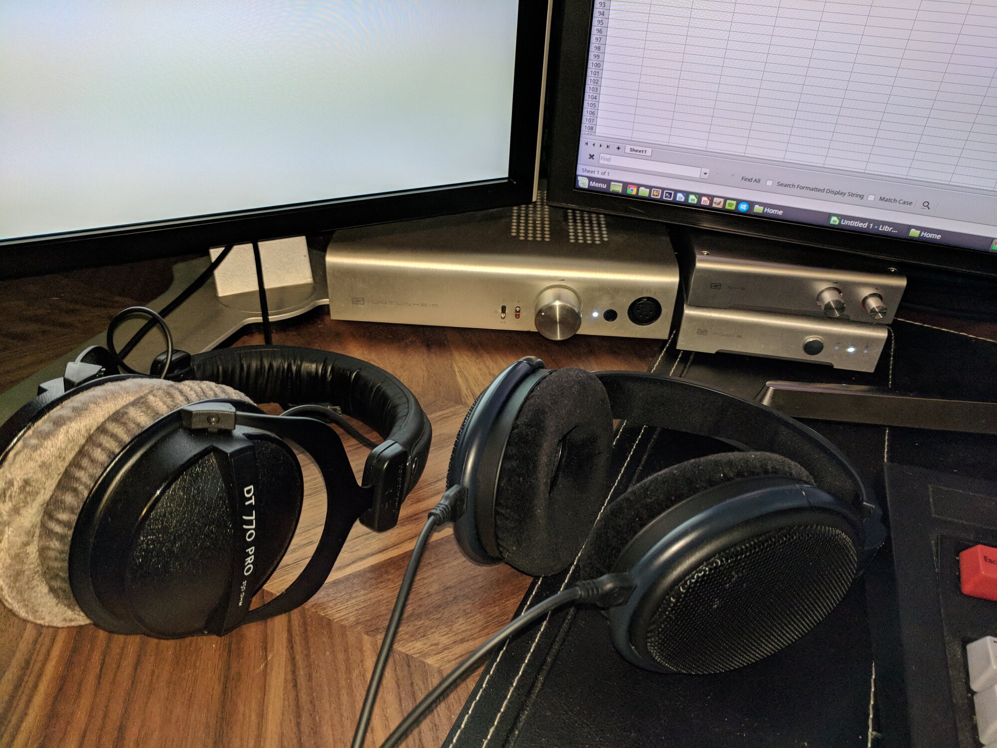

x509
Audio chips - I'm no audiophile but I can't hear the difference between the entry level Realtek audio and the higher end realteks which people say are quite good. You probably need very good equipment and a good ear to notice. Otherwise, probably no difference. The higher end boards do have the optical out, which some people want though.
Chipset SATA ports - I think based on all previous reviews, ones that are linked directly to the CPU tend to do the best. These are the Intel/AMD ones, and not the ones that need to pass through the ASMedia chips.
For Ethernet - They say Intel > Realtek, but I've used realtek ethernet for years for our cheapo office computers and haven't had a problem except for the odd Linux driver issue on the Realtek 8111F chips.
Past a certain featureset, I'm more concerned with the quality of components and quality of manufacturing/design which you can only indirectly derive from how long the board lasts under non-extreme use. (Since your sample size with that board is probably = 1, I admit this is more anecdotal as opposed to scientific)
My Gigabyte X38 died very early but out of warranty, and I wasn't very happy about it. When I buy a 300$ board, I expect it to last me until I throw out the system. I wasn't running it in extreme conditions, had a Q6600 at 3.2ghz at close to stock voltage (1.275-1.35V, where the highest VIDs on Q6600s was 1.325 IIRC) and in a mesh case with lots of fans, with an HEC Power supply (best I could find in my country at that time) that is still alive today in another machine.
I haven't bought an ultra high-end board since, with the exception of this Crosshair 7 which I got used from an [H] forumer at midrange price.

it sounds like Realtek doens't make the best audio chips
Basic point is this: it's up to the board's implementation. A good implementation can be fairly unimpeachable. As to the parts themselves- they punch so far above their weight that no one else tries.
It isn't the audio chip that sets them apart so much in terms of sound quality. The difference between an ALC892 or an ALC1220, S1220A, etc. is features. It's all in the quality of the implementation. These days they are all pretty good in that they have isolated electrical and separate PCB layers for left and right audio channels, etc. If you do hear a difference, nine times out of ten its because of the OP-AMP. Even more confusing is when boards have multiple DACs onboard. One typically services the front panel while the other the back panel. So how you use it makes a difference too. Optical output is desirable because its digital. If you take that to a receiver then its all about your reciever or other input device. At that point your computer's onboard audio can be the most basic crap ever and it won't matter.

Few counterpoints for me. I always use a sound card on a build for games. I have never had an issue with throughput on realteks.
