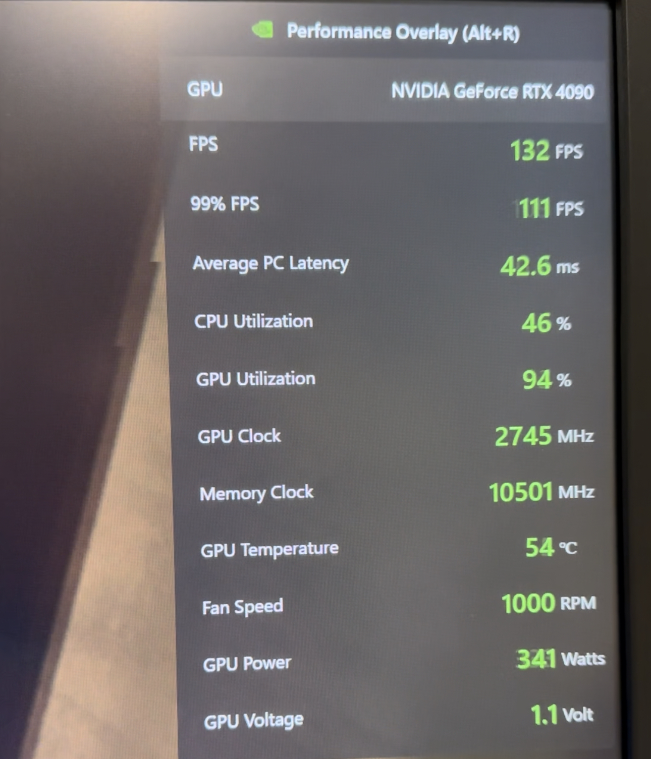

I have a seasonic focus gold 850 watt + i9 18500k + asus TUF OC 4090. All at stock settings. Been stress testing it with cp2077 at 4k ultra RT (psycho) settings. I haven’t had a single issue with stability. Seems like the max power draw from gpu when playing is about 350 watts or so.
I’m confidant that 850 watts will be plenty for my setup.

Burticus
Nov 7, 2005
4,891
Nice! Gives us all hope that we don't need to run out and buy 1000w PSUs
ilumo
Weaksauce
Sep 2, 2006
72
Yea. I was afraid at first. To be honest I did some back to back testing with my 3080 and my 3080 was drawing just as much as my 4090 but running much hotter so I’m not sweating the power anymore.
