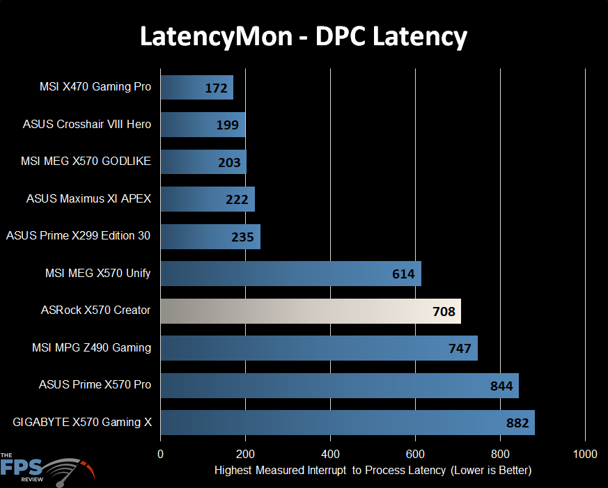

I'm wondering if people had a significant DPC discrepancy between their previous build (likely Intel for enthusiasts) and their new build (often AMD now)
That would be something you could measure, but wouldn't not think to check or compare. It would explain a difference in perceived smoothness (DPC can interrupt USB mice, etc) and may make you incorrectly attribute the difference to the new AMD platform.
This is actually a fantastic point. This is something I can actually test and have. Here are some results I've seen from recent motherboards I've tested. The only problem with going down this rabbit hole is that the results vary wildly based on a given motherboard, driver revisions, firmware levels, and whether or not you've installed the motherboard vendor's software suites. One interesting thing to note is that the systems with lower DPC values were actually tested on an older build of Windows. Older driver versions, etc. That too factors in. One note on that, is that the ASUS Maximus XI APEX and MSI MEG X570 GODLIKE were the two used for my 3900X review, and the Maximus system felt faster, though the DPC latency values don't necessarily agree with that.
These are maximum values, which leads me to start thinking about looking at their average values now as I think those matter more. The average values on some of these boards are incredibly low, but they sometimes spike quite hard. The test was actually designed to simply make sure that it never broke 1000, as that's where things get bad. But you might be on to something.
I think this is a great point and my own highly subjective experience suggest to me that DPCs in Windows and general interrupt handling is the single largest lever. I say this because were someone to ask me what is the "smoothest" system I own, hands down I would say it's my 2012 iMac or 2016 MBP, even compared to my OC TR3 3960X, despite the latter being objectively faster than both by a wide, wide margin.

Wow, this spread is rather something. Yeah, I'd love to see a mean/median, or a histogram for each board.
I never thought about it before. It was a test that, even when systems would break 1000, never seemed to give me any issues. It's something people wanted to see, but as long as it didn't break that magic 1000 barrier, it was considered all good. But, it would be interesting to see if there was a correlation between DPC latency and perceived smoothness or responsiveness from one system to the next.
It would be interesting to swirl the cursor around in circles while opening windowed programs, (or dragging windows around for a length of time) on both a high and low DPC system to see if there is a difference at all. I have encountered systems that tend to stutter the mouse frequently, which does not feel "smooth" to me subjectively speaking. But I have no idea if that is DPC, the USB controller/driver or a bus that the USB controller is on getting interrupted by another device.

It would be interesting to see. I can do some testing on this and find out if I can perceive any difference. I'm reviewing the GIGABYTE Z490 Aorus Master right now. I've got a Core i9-10900K in that one. My main rig is a 3950X, I also have a 3900X on the test bench.
I'm using a 3900x on a X470 Gaming 7 WiFi. Anand review claimed DPC of 108 for that board, but that was a previous BIOS version. So I noticed you used LatencyMon and was going to test my own and came across this:
From https://resplendence.com/
About DPCs and ISRs
The Windows thread dispatcher (also known as scheduler) which is part of the kernel executes threads based on a priority scheme. Threads with higher priority will be given a longer execution time (also known as quantum or time slice) than threads with a lower priority. However the kernel also knows other types of units of execution known as interrupt service routines (ISRs). Devices connected to the system may interrupt on a connected CPU and cause their interrupt service routines to execute. An interrupt can occur on the same processor that an audio program is running on. Any thread that was running on the processor on which an interrupt occured will be temporarily halted regardless of its priority. The interrupt service routine (ISR) is executed and may schedule a DPC (Deferred Procedure Call) to offload an amount of work. The DPC will most likely run immediately on the same processor which means the audio application will halt until both the ISR and the DPC routines have finished execution. That is because ISRs and DPCs run at elevated IRQL which means they cannot become preempted by the thread dispatcher (scheduler). Therefore to guarantee responsiveness of the system, ISR and DPC routines should execute as fast as possible. Guidelines say that they should not spend more than 100 µs of execution time however this is often not reached due to hardware factors beyond the control of the driver developer. If execution time gets too high, the audio program may be unable to deliver audio buffers to the hardware in a timely manner.
This seems to suggest a target of 100 microseconds and a possible explanation for a perception of the smoothness claims. Unless I'm not reading this correctly, more cores means less chance of a interrupt halting your current task. Does that seem plausible?
