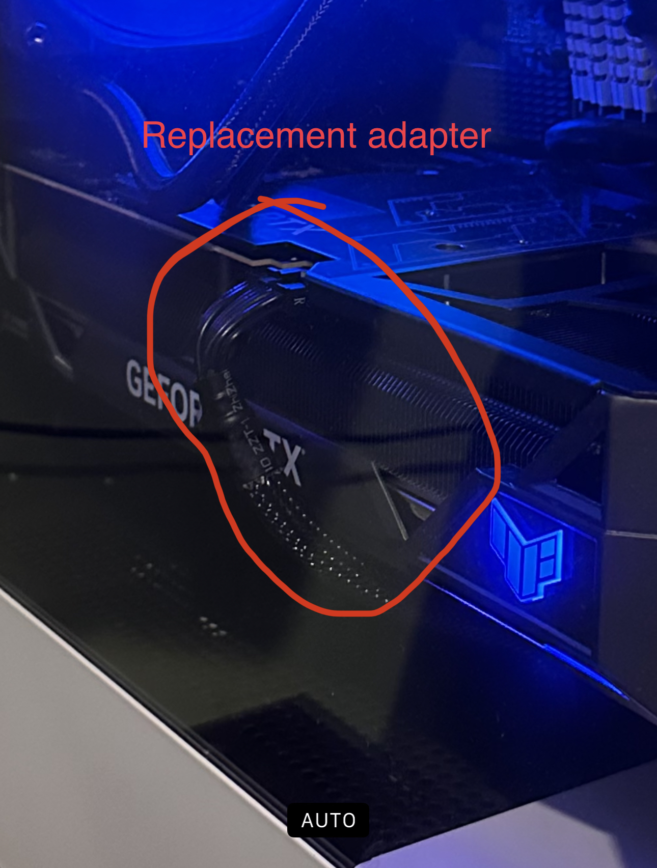

Actually. I have a tangential question. I have a 3 + year power supply. A seasonic focus gold 850 watt ps. With an asus TUF OC 4090. Stock i had 2 cables that plugged into the PciE port on the power supply end and then a 1->2 adapter that I then plugged into the 4 plug to 16pin adapter.
I had asus send me another cable which was essentially a “Y” cable with 2 plugs in one end into the pcie slots on the power supply and ONE 16pin connector on the other end that goes into the video card. Which one of these methods are better? The one that came in the box seems better made, but I can’t close my case with it and it has 4 additional plug connections I have to make. The replacement cable is more streamlined and I can close my case, it the 16 pin connector seems more exposed and less well made. Let me know what you guys think.
For further peace of mind, I played cp2077 for 30 min and then took my thermal cam and aimed it at the connector (when case was open. Gun can’t measure through glass) and got a max temp of 101F under load.

Yea. Which doesn’t seem to bad IMO. But I don’t know what the temp of other “connectors “ should be. But assuming that a “melting” / soon to be melting connector should be much higher.
I also have been in this config for the past couple of days. With a few 3+ hour gaming sessions without any issues so far.
Maybe this whole connector thing is overblown?

Yes. I figured that a poor connection was likely the issue. That said that’s more of a user competence issue rather than equipment issue.
However in my case I just wanted to see which would be better. The 1->4->2 connector or the 1->2 connector. I’m leaning on the latter.
However it seems like asus sent me an aftermarket connector. That’s my only hesitation of going back to the original adapter. I emailed asus to see if the cable they sent me would void any warranty if something were to happen to connector.
The combo focus psu + asus 4090 + i9 18500k has been rock solid so far. I’m happy with it.

to further qualify- I meant poor connection which includes overstressing the connector at the connection point. That would have been my case if I tried to close the side panel with the original adapter (picture attached). Or it would have snapped the connector on the gpu itself. That said, pragmatically speaking, something like this should be a red flag for a builder anyway.
