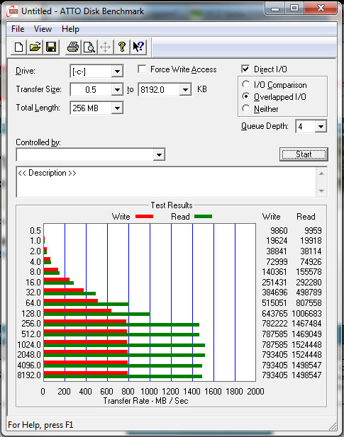

Haven't seen too many benchmarks with this combo.. just got through with the first atto run.. I think maybe some caching going on cause it seems high to me. I plan on adding a couple more when the prices come closer to msrp. I can run another bench if anyone's interested. Raid is set to default 256k stripe.
as ssd seemed to get different results each time I ran it.. hit 900's seq and 22's in 4k a couple times?

This Adaptec specifically (6000 series) and older Adaptec 5000Z series (only Z wich supports ZMCP like a 6000 series), both have 512mb but, the 4gb SLC NAND it's not cache, it's just a "space" wich ensure that data is stored from 512mb cache to 4gb SLC in case of power failure. Although, it could be very helpfull on random read/write works, since the controllers read and safe to the cache and pick up quicly from the cache to write on SSD or HDD. It's a major rule if Read Ahead cache and of course Write Back cache is enabled.

Forgot to tell one thing.
Your results are right. It seems high because of cache.
Since controller has 512mb cache, up to 512mb of data,they are red and wrote very quickly (more than 1gb/s surely).
You can test it using Crystal disk mark with size test up to 512mb. Certainly you will see 2gb/s sequencial. Put 50 ou 100mb and see :). Same thing on ATTO.

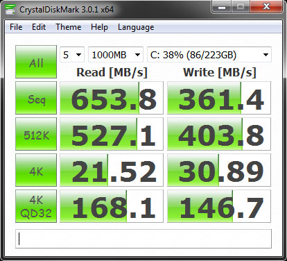

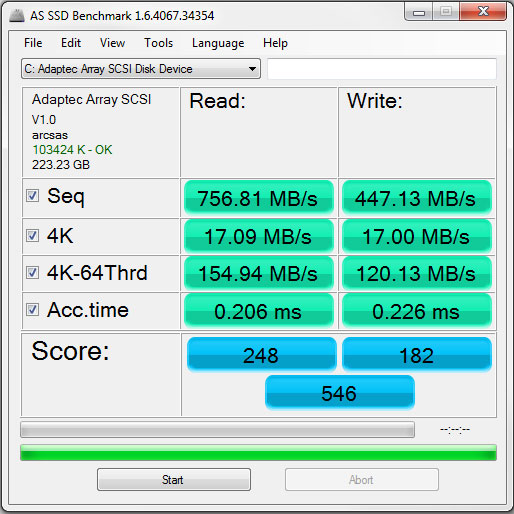

Hello all,
Bit of a resurrection here I know,
just got my second 120gb vertex 3 maxiops, and I'm running RAID-0 now.
I did however clone my existing install to the raid partition. Used snapshot and alignment carried over correctly. Seems I'm getting some weak write speeds however, the rig is in my sig.. anyone have any ideas?
Write back cache is enabled in RST.
