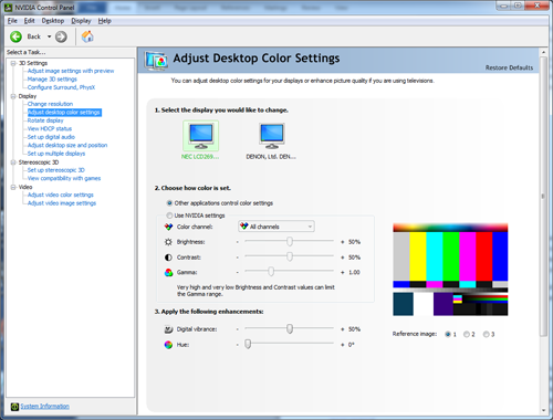

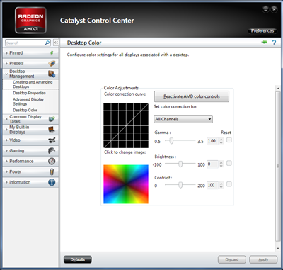

The first step on both systems is to make sure that all onboard color modifications are turned off. We know that the cards can change the color if they want, the question is if they are different despite settings. That means having brightness, contrast, gamma, digital vibrance, hue temperature and all that set to no modification.

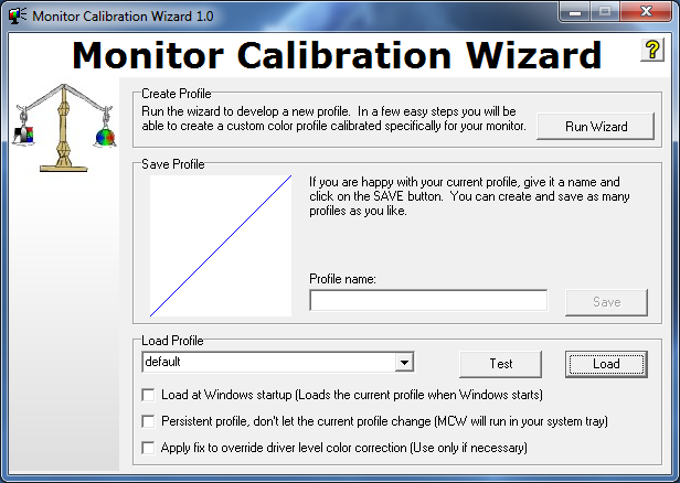

Then I’ll use Monitor Calibraton Wizard just to make sure the system lookup tables are unaltered, a straight line.
