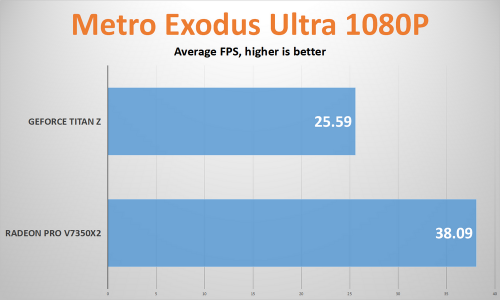

Now it’s time for benchmark. In comparison, we test it against the Titan Z, since that’s the last dual GPU consumer card Nvidia has to offer.
Here you can see the benchmark results. Please note, I’m not really cooling it with the appropriate way, so the result is just FYI. It is thermal throttling quite a bit.
In 3Dmark Timespy, it is about 20% faster than a Titan Z, and remember that’s with thermal throttling, according to the seller I got this card from, it is able to achieve about 1000 points higher if you cool it properly.
In actual game testings, it has a significant lead over Titan Z.
In Geekbench 5 compute testings, it almost doubles the score of Titan Z in OpenCL, but it’s still considerably slower than the GTX1080.
