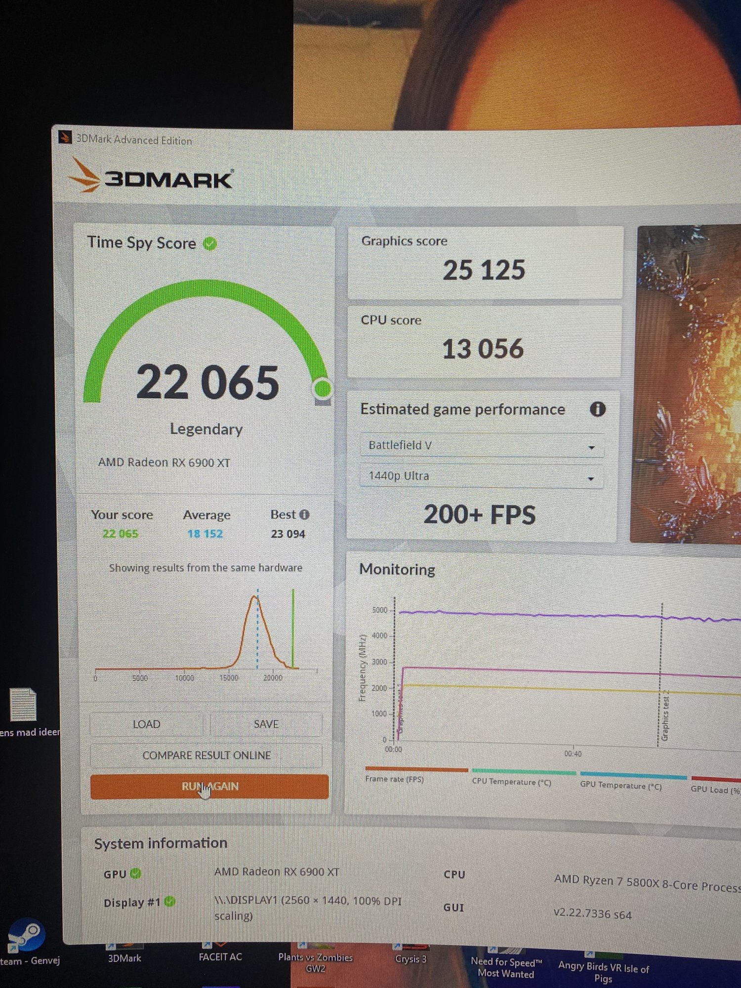

hmm just tryed some other tweaks with mpt and ended up with this
http://www.3dmark.com/spy/26591545 25799 or something graphic score..
but now it says graphic driver not approved like wtf???
update... reinstalled to latest driver (even though last 1 was the driver before this..)
ended up with 25 627 graphic score VALIDATED now lol.. http://www.3dmark.com/spy/26614660
seems like the newest update isnt as good for timespy. else something is wrong, wont pull more then 580w even though i removed all limits and made it 800w limit and 1.4v it wouldnt go higher for some reason..
tryed higher fclk soc voltage etc but nothing...
retestet this with 1.3v, still same score, and tryed lowering watt to max 500+15% pl, still perfect for gaming. so this is surely a game able profile i just made... but for everyday use with full consumption i still hit like 700-800w combined with screen, so ill settle for my eco settings, making roughly 22500 graphic score etc and a combined watt usage of only 400w

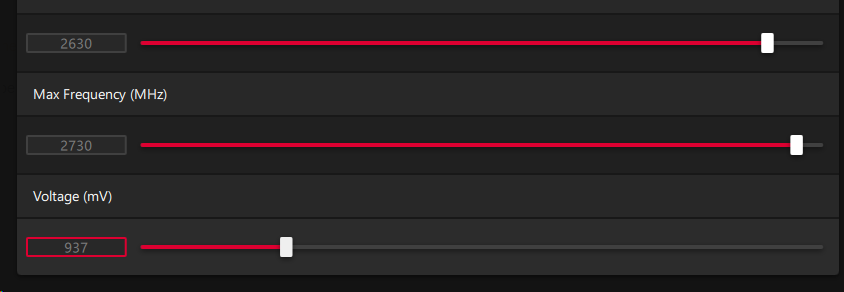

At stock, these cards (6800xt - 6900xt) are very overvolted.
You can max the power limit and try how much you can lower the voltage for the same MHz.
As an example, my current daily settings (6800XT):
Nordskov
Feb 25, 2022
14
I cant go lower Then 1175 at 2600mhz. Even if i go 2300mhz i cant go below 1175mv Then crash in timespy. But i Can do like 2800mhz at 1175 though. 2900+ requires 1.280v to be stable games. 1.3v and 2882 is Max ill get in timespy even 1.375v wont boost it higher for timespy. Only firestrike

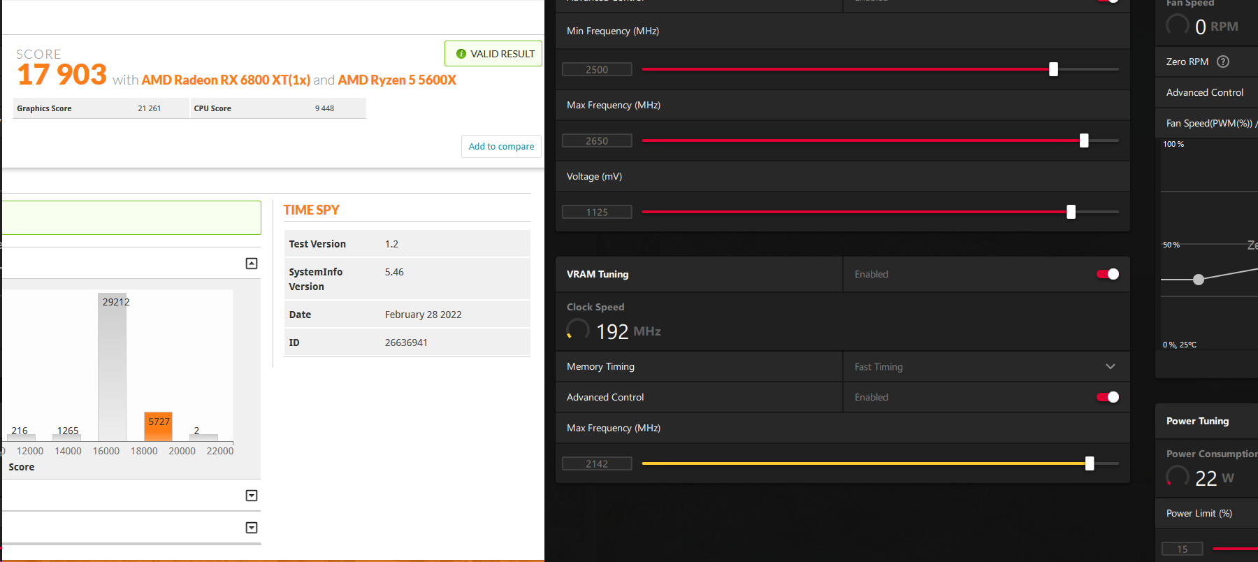

Damn thats not bad. And what a Nice temp aswell. Gotta love these Cards. ✌️😃
Especially for Time Spy, I go for lower MHz because I hit 324W and a bit more voltage.
But this thing (TC) is synthetic software and it just uses as many resources as it can get so it is irrelevant.
For example, I hit this result in Shadow of the Tomb Raider Benchmark with these settings which are 100MHz higher than Time Spy and maybe 50W lower...
AVATARAT
Jun 16, 2020
220
For Time Spy this are my settings which is far from normal gaming settings:
If I want more I need to set a higher power limit. And if for benchmarks this is fine, for normal gaming is near to pointless, because perf/watt will become really worst.
https://www.3dmark.com/3dm/72606418
For all 15+ benchmarks that I play, 3DMark benches are a lot more power-hungry than everything other, and because of that I do not like it :LOL:
