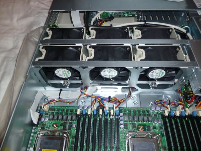

Alright, I got the barebones kit in today. I figured I would make a thread because I know a few others are considering it.

Now that the system has been running for awhile, I can update you with temps. It seems the back left cpu (cpu1) seems to run about 10 c hotter. Possibly due to poor airflow. When folding, temps sit at about 40-42 with the fans at a notch slightly above medium. For a point of reference, the 212+ in the same rig (while in the case) sit at 29 - 32. So, if you can handle the extra size, the 212+ run much cooler and quieter.
Here are a few pics of the cooling:

It really does sound like an airplane taking off, go figure. Those coolers look well made, with fans like that they must be icy cool.

The noise is expected on these 1U/2U Servers. They were designed to be placed in a Datacenter where noise isn't a problem.

Very nice. Is there enough room to run it lidless with MuskyMount TM style Hyper 212's?

Looks like you would only need to MuskyMount one of the 212+, the others you could mount the simple way. You could still rack mount it too, just with 5U spacing.

Spot on zink. The case only gets in the way of one of the cpus, the rest can just be angled.

42C is just fine for temps. I'd actually keep cranking the fans down until you are sitting @ 55C or so and see how tolerable the noise is. You have some headroom to play with, especially with the 6128s.

I hate to be mister obvious here but if you are running that server with the cover off it will run hot on the left CPU as there doesn't look to be anything forcing the air through that back left CPU.

I'm not running it with the cover off. I was working on things at the time the picture was taken. Since I have stacked them all, as a rack setup (given, without the cabinet) should be. However, even with the cover off, it still is most fine. The barebones kit includes a plastic fan shroud that covers all the cpus. I think you can see some of the glare in the picture.
I stand corrected.
