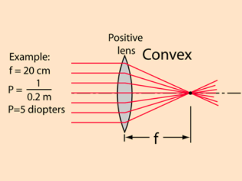

I am fine with it, my eyes are getting old :). I have to use my glasses with the C2 42" now at about 24-32", scaling is at 125%
I saw someone's reply recently in thread saying they got a set of glasses with a prescription specifically for their desk setup and display which seems to work out better for them. I use my regular daily driver glasses and have no prob with 60PPD - 80 PPD at default text sizes but considering the amount of time I'm at my desk I wouldn't be opposed to doing a specific prescription pair for my setup. My laptop is 16" so around 15.5" at 2560x1600. That's around 64 PPD at 18" and a little higher if nearer and I use it at 100% scaling. I'm farsighted so I need glasses for seeing nearer. Pointing out the laptop because I can see over 60PPD at default text sizes at 18" or nearer as well as my 48" cx at 38 - 40".
The point in my previous reply was that I feel the criticism of 1440p 45" is warranted but that a 42" 4k at 24" view distance is comparable to a 1500p screen's density and more fringed PQ - and if upscaling text/interface then in the desktop real-estate aspect as well, but at the near distance the viewing angle additionally making more of the sides of the screen off axis creating a larger "eye fatigue zone" and color shift gradient zone on each side. Sitting at the radius or focal point of a curved screen and the whole screen surface would be equidistant from you and not off-axis. So it's not as simple to compare that 45" 1440p (negatively) to 4k PQ and real estate imo unless you are using the full PQ a 4k screen is capable of. Otherwise it's more like 1400p with uniform viewing angles vs 1500p with off axis viewing problems.

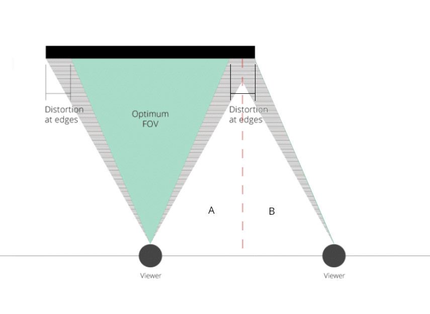

Realistically, I only ever use my monitor sitting Infront of it, and I prefer curved, even with the 42" at 3 feet away I feel like the edges are bent outwards (I know they're not) but my eyes are picky now that they have been spoiled with a curved display. I would probably be happy with the 42" in a curved format, but that is $2500+ now. I get the PPD issue, and while I would prefer higher PPD I am just not seeing anything yet that fits what I am looking for better than that 45" (apart from cost, which will come down eventually)
They are definitely off axis which isn't optimal and it also makes uniformity issues a larger area and more obvious on VA and OLED screens. The edges of the screen are off axis as much as if you were viewing the screen from an equivalent distance outside of it.
Made even larger when sitting at sub-optimal nearer view distances. Larger the nearer you sit, as the degrees of area beyond the middle 50 to 60 degrees grows since your viewing angle is larger in degrees. It's also a larger area outside of your viewpoint so results in a lot more eye darting and to larger distances ~ larger "eye fatigue zone".

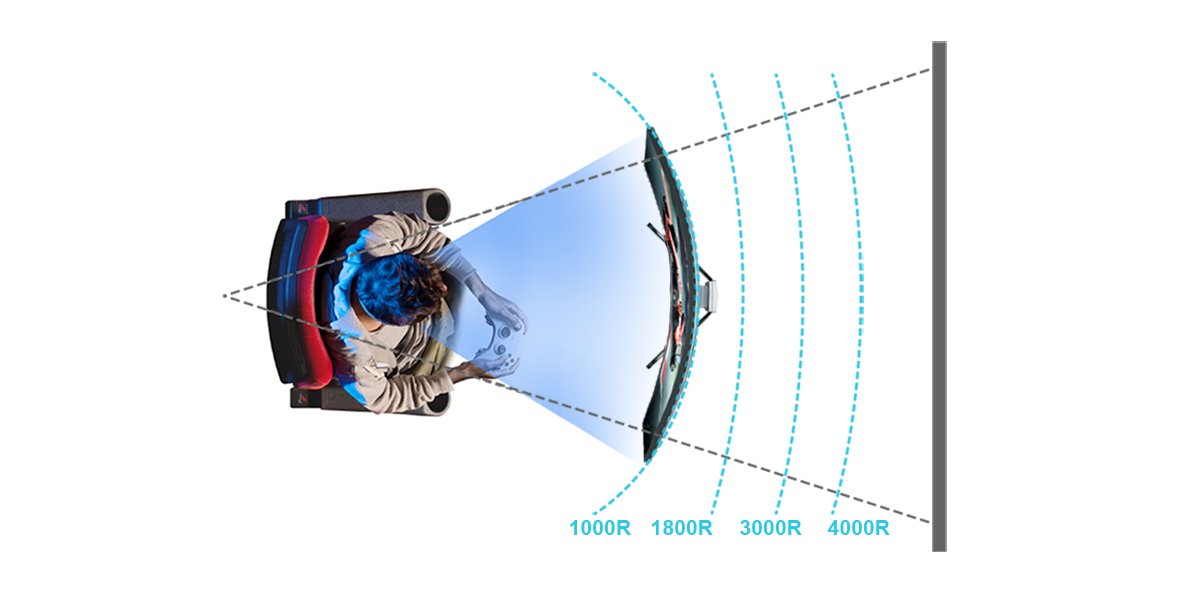

With curved screens, at least when sitting at the R value distance (e.g. 1000R = 1000mm= ~ 39.5" view distance), you'll be equidistant from every point on the screen surface with them angled directly at you like the focal point of a lens.

While true, this comes with the downsides of also requiring a specific optimized distance that if you don't meet means a far greater image area will look incorrect (distorted and likely suffering greatly from "off axis" viewing). If "bendable" displays existed in the consumer market and you could control the curve as you note in the various "R curve" chart, then viewing distances could be interchangeable. A flat display will never have these problems.
And this is of course not discussing any of the other obvious problems such as things like straight lines for those of us that work in visual mediums and not just "gaming" or "productivity". Given the tradeoffs and the fact that I edit photo and video, I doubt I'll ever move to a curved display other than if I have the disposable income for a "gaming only" display. And even then, because the distance has to be so controlled, I'd have to be VERY convinced that the size, curve, and distance, were all optimal before pulling the trigger (not to mention other important specs like refresh rate, display tech, etc).

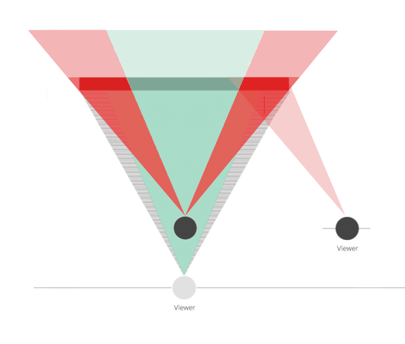

Both flat and curved screens have optimal viewing ranges or viewpoint. The curved ones restrict you more obviously to the optimal view distance like you said, being that the radius or focal point of the curve is fixed on most of them. Or at least you'd think so - people can still sit too close to curved screens and cut the sides off and misalign the curve focal point wise so to speak. If you think their R distances as a focal view distance are too far at 1000R and less, at least on large screens, you may be viewing your large flat screen from a sub-optimal (too short) view distance and suffering off axis viewing angles at the sides, which on an oled not only puts the larger amounts of the sides of the screen in the eye-darting range but also makes the non-uniform color issue on the sides of the screen larger. It also lowers the PPD, which below 60PPD means AA and text sub sampling won't be able to compensate enough anymore (and there is no AA for 2d desktop graphics and imagery either so worse there).
The viewpoint for a flat screen is within a 50 to 60 deg viewing angle. Yes you can use one at worse angles and get away with it but it won't be full PQ, including both viewing angle but also PPD for 4k (rather than 8k) screens.
When you sit closer, you end up with something like this along with lower PPD:

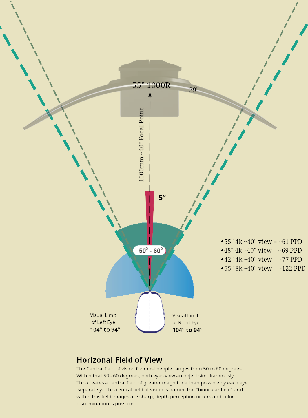

Regarding flat lines, productivity, video and photo editing - there is probably a reason most reference monitors are 32" - 35" (flat) screens.
However it's all about PPD and viewing angle:
42" 4k screen at 50 deg viewing angle is at 39" view distance and gets 77 PPD
42" 4k screen at 60 deg viewing angle is at 32" view distance and gets 64 PPD
40" 4k screen at 50 deg viewing angle at 37.5" and gets 77PPD.
40" 4k screen at 60 deg viewing angle is at ~ 30" view distance and gets ~ 64 PPD.
32" 4k screen at 50 deg viewing angle is at 30" view distance and gets ~ 77 PPD
32" 4k screen at 60 deg viewing angle is at ~ 24" view distance and gets ~64 PPD
Those ranges are more what you are talking about for a direct view of flat screens and straight lines. A 40" - 42" flat screen at 38" to 39" away, 50 deg angle at 77 PPD for more direct view and finer perceived pixel density (including uncompensated-for 2d desktop graphics and imagery) isn't that far from the ~39.5" view focal point of a 1000R curve however if critiquing distances. Some of the newer curved screens can do up to 800R though which is 31.5" radius or focal point. So a 42" curved 4k at 800R, ~32" view, would be around 64PPD for reference.
Personally I'd like a 48" to 55" 1000R 8k screen someday, being able to run 32:10 rez or 21:10 rez, or even 4k or so rez on one on part of the screen when I chose to. It would be a multimedia and gaming screen primarily though, especially if OLED. I'd have other screen(s) for static desktop/app usage. I've used 2 or more screens since at least 2006 due to tradeoffs in display types. While things have changed tech wise on a lot of fronts there are still tradeoffs between different screen technologies and usage scenarios.
In the meantime I'd prefer a 4k gaming screen with a curve that allows for nearer to 70PPD+ at the focal point if i can get one in the next few years. The 55" ark missed the mark on a lot of things (tech wise + price wise) to begin with, but at the focal point it was only about ~ 62 PPD which while over 60PPD isn't as high as I'd prefer. I think a 48" 1000R OLED would be great as a multimedia and gaming display. It'd get higher PPD (~69 to 70 PPD) but wouldn't lose too much immersion size-wise for full screen gaming. Again a 42" flat at 50 deg and 39" view is 77PPD so wouldn't be a bad combo with 1000R ~ 39.5" focal point but a 48" to 55" screen would span to 60 deg or more so would be a little more immersive at that 1000R distance/radius. 42" screen at 60 deg (64 PPD) would be more like 800R (31.5 inch) distance wise so I'd say 900R (35.4") to 1000R (39.5") would be better all around for a curved 42" with PPD considered. That goes against the reason a lot of people buy 42" OLEDs though which is the smallest desktop OLED they can shoehorn in to a shorter desk setup. Still a square peg into round hole though imo in a lot of setups but mostly due to the fact that there are no 30" to 35" similar OLEDs.
