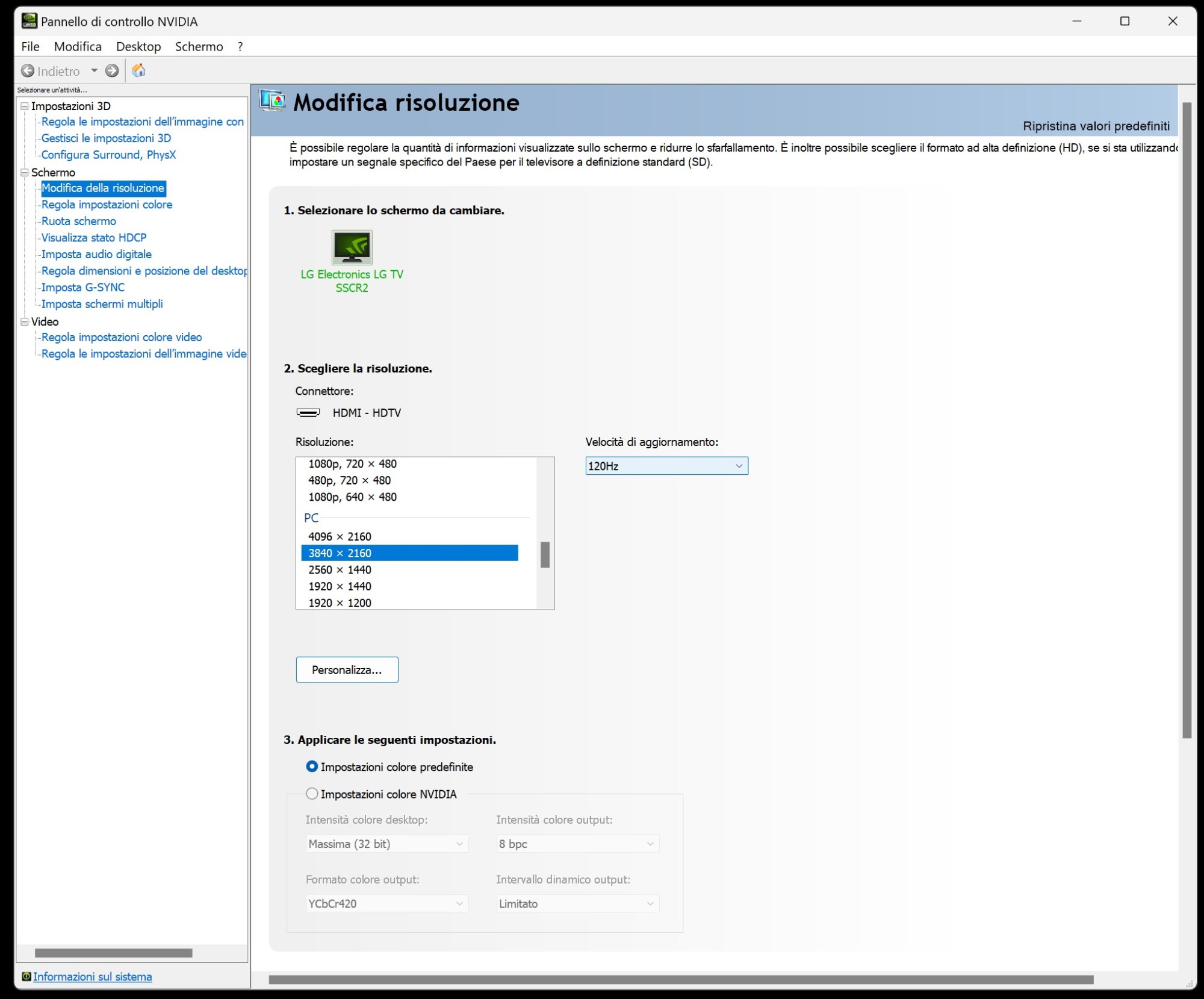

Guys according to you what could it be that with oled C2 as a resolution I can only put in PC mode 2560x1440 120hz, I use the same settings as the C1, I updated the firmware, changed the hdmi cable, reset the tv, but if I reconnect C1 I can safely put 3840x2160 120hz video card 2080ti in your opinion and the tv to be replaced?
DooLocsta
Jan 26, 2005
1,762
2080ti over HDMI you are only going to get 4K 60Hz at 4K. Limitation of the HDMI spec on the card
Superino
Jan 13, 2021
8
forgive my english i use google translate.
the strange thing that using oled C1 with the 2080 I can get you 3840x2160 120hz with its limits. Both with hdmi 2.0 and 2.1 cable
using Oled C2 I can only put 2560x1440 120hz.

Do you have shot running 120hz on the C1 at 4K. It isn't possible on a 2080Ti with the HDMI spec unless it is running 4:2:2 I think?
Superino
Jan 13, 2021
8
I was limited, I would not want oled C2 to have any defects

kasakka
Aug 25, 2008
2,901
You can have 4K 120 Hz if you set it to 8 bit color, 4:2:0 chroma subsampling and turn off HDR.
Otherwise upgrade GPU or buy a DP to HDMI 2.1 adapter.

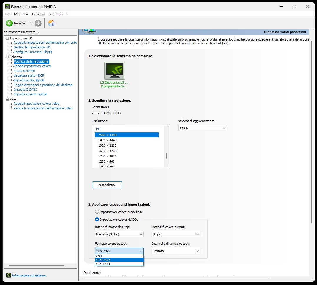

Superino
Jan 13, 2021
8
made 4.2.2 8 bit na on the C2 I always 2560x1440 120hz
if I connect C1 I can also select the 4k at 120hz with its limits
Superino
Jan 13, 2021
8
here is Oled C1
I came to the conclusion that C1 can be used 4.2.0
in C2 there is only 4.2.2
isn't there a way to enable it?
