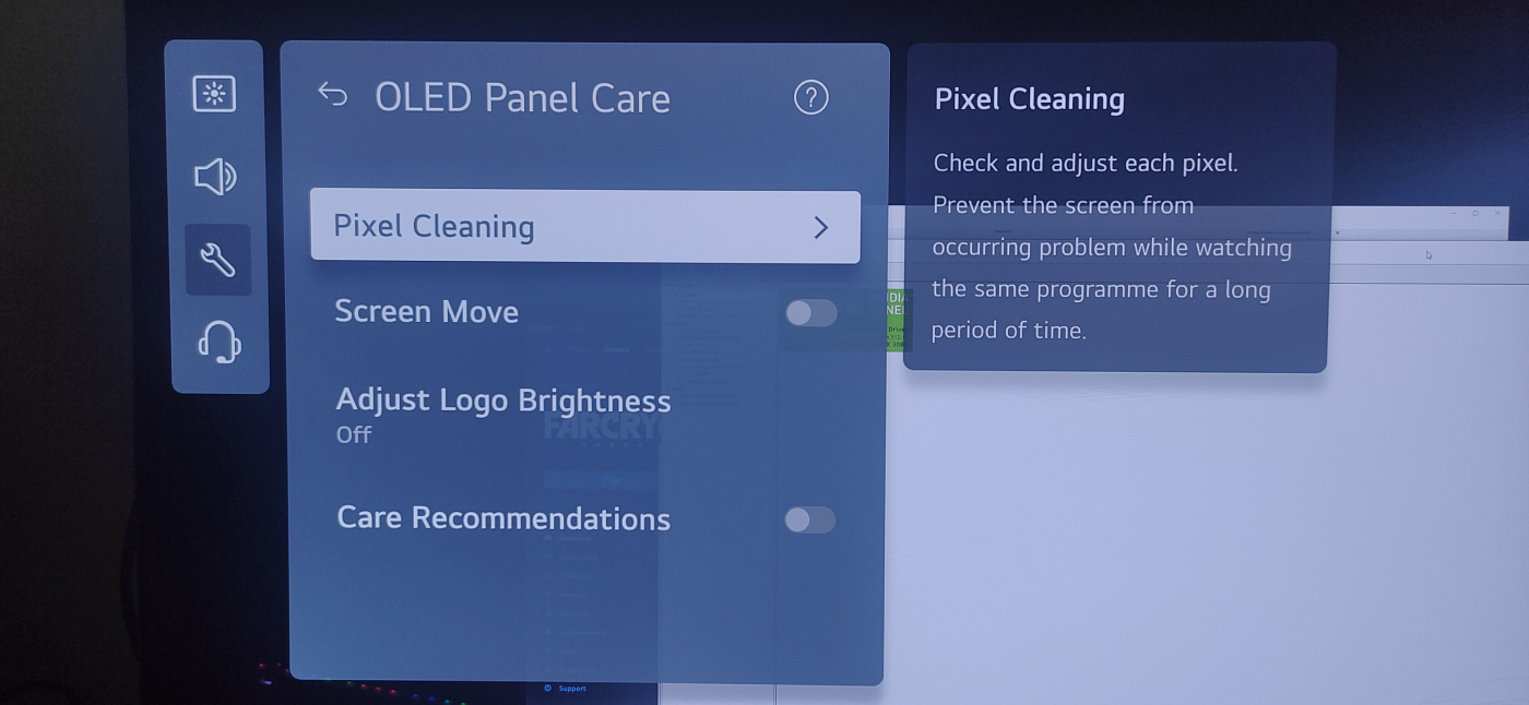

how often do you have to run Pixel Cleaner? and at google, they only have JScreen Fix. No Pixel cleaner
Murzilka
Dec 11, 2011
1,055
No idea what JScreen Fix is. Pixel Cleaner though:
I run it once to clear the dark clouding caused by the desktop icons that were burnt in in such form. Or image retained or whatever... So, having icons on your desktop is outta question with the 42c2. For me at least.
The clouding would probably dissolve by itself, since the task bar was never hid and it shows no sign of burn-in, but I guess I didn't want to wait. After the procedure - the screen became white as an A4 sheet of paper.

This option age all pixels to the level of the "oldest" present. Thus you're basically dimming the whole panel to the level of the dimmest (burned out) pixel. Not a very good solution IMO.
I haven't noticed any dimming. The screen is bright as fuck. It got to be much less bright if it matched the dark spots.
You don't. It is done automatically after x hours of cumulative use on the LG OLEDs when the display is turned OFF as long as it's connected to power. It is invisible to the user. While you can run it manually, I haven't done so during the two years owning the LG CX 48" and using it as a desktop display for work and personal use. No burn in.
kalston
Mar 10, 2011
1,343
There is no point running it manually basically. If you notice an uniformity issue that you are certain wasn't there before, then you can try to force it, and it may help. But most people shouldn't worry about it.
Saying you are dimming the panel every time it runs is not wrong but those panels leave factory with ample brightness headroom. Which means that, instead of dimming the whole panel, they can keep pumping more voltage into the dimmer pixels for a long time - and thus you don't see any dimming (until you do, of course but talking years of heavy use here). There is ample evidence of this with tests such as the ones done by Rtings.
