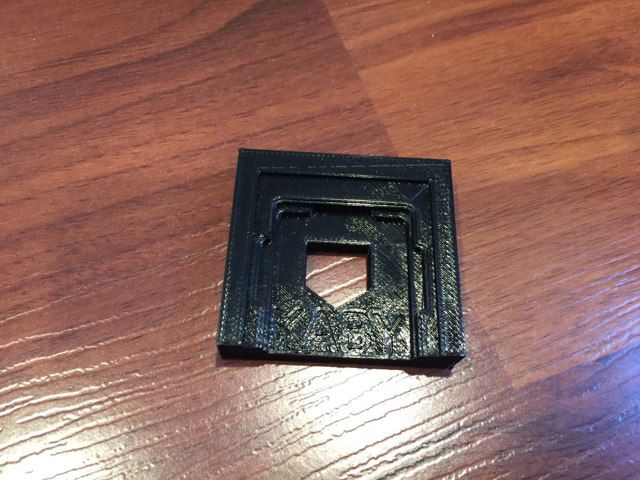

This was posted over on the 3D Center Forums. The post points to an "Intel Kaby Lake delid tool" design that can be implemented on a 3D printer.
A simple delid tool that for chopping Intel Kabylake and Skylake CPU
The author of the design does not have a 3D printer to try it out and test on, but I know some [H]'ers that do. If one of you guys wants to print this up using some "[H]ard" plastic, which I think would certainly be needed, I will subject it to abuse here if you want to ship it over.
Hey Kyle, I printed this out but don't have a chip to try it on. I'd be happy to send it to you. If you want it shoot me your address (PM) and I'll get it out for you tomorrow.

The assumption here is that the force needed to break the glue is spread around the IHS instead of just using blunt force to one spot or side. I'd assume it would be safer... it looks like it'd be safer. Personally I have the rockit delidder and that uses a screw to apply force to the IHS.
http://www.tomshardware.com/news/auqa-computer-skylake-delid-spacer,30806.html
Oh I fully understand how it works, if machined exactly you would be putting force on the four corners as you turned it. Not exactly rocket science. But the fact is you are using "blunt force" on four pinpoint spots at the corners instead of evenly along one edge. I am not arguing for or against here, just sharing my thoughts after delidding a few here with this Delid Die-mate Tool.
The Aquacomputer one is much harder to print than the one which uses a vise. I have tried them both. The locating pins on the Aquacomputer are the fragile area and easily broken. I broke three during assembly of the tool. Ended up taking four button head screws and used them as the locating pins partially screwed into the base.
The same guy who did this Kaby Lake model has ones for Sky Lake and Ivy Bridge also. It is very simplistic in design and it just plain works. When I went to delid my 6700 I did use a small blade to ease the corners a bit before sticking it in the tool. Then it only took two complete rotations of the vise handle to pop off the lid. Easing the corners was probably completely unnecessary.

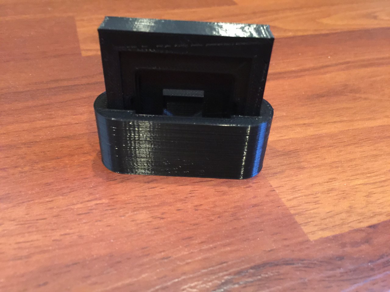

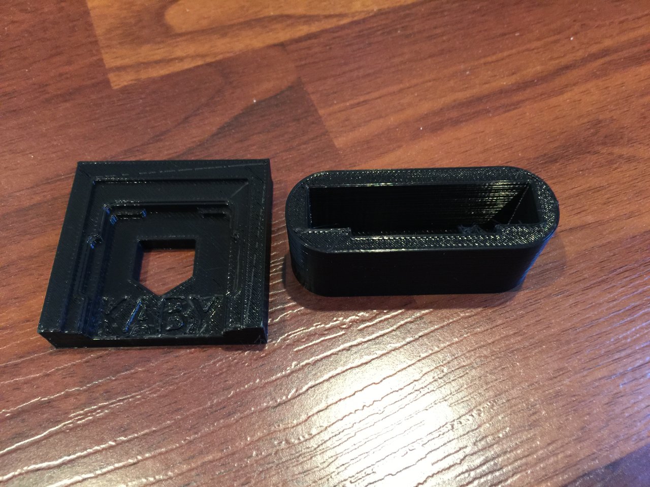

I just 3D printed the Ivey Bridge one and Skylake one. I'll be trying it out on an IvyBridge CPU tomorrow. :D
Then, if it turns out to be successful, and easy, I'll do it to my Skylake Proc.
I'll probably print the skylake once I see if there's a difference between the 40% and the 100%. All I've got right now is PLA, hope that's good enough!
Ohh and I need a vice.... I have a c-clamp that would probably work tho.
I was about to delid a 6700K for the tool test, but figure I might as well get some temps first. DOH!
geeze that shock when it let go was a bit unsettling!! I might have to redesign/do a bit of tweaking to that design to alleviate this if i give it a go!

as long as the cpu holding block is hitting the inside of the pressure piece at the same time or before the cpu hits the edge of that overhang it should be a non issue. at that point the only risk is if the whole thing shatters.
The originator used a piece of foam on the inside to cushion the blow. At least on the first one posted to YouMagine. I used mine just like Kyle did (sans foam) with no issues.

Oddly disturbing *and* satisfying when it went POP. The 40% tool looks like it held up quite nicely. But would it hold up after several+ beatings?
