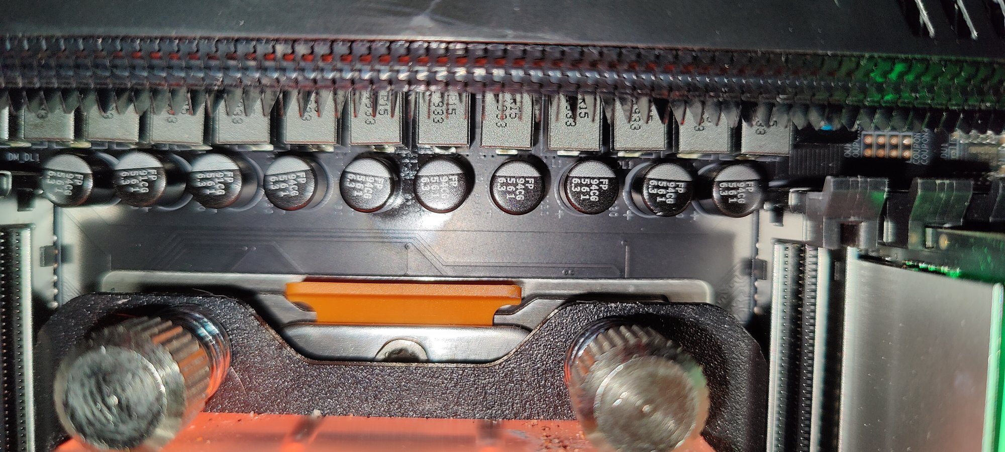

These things are odd I miss the days of it either works or doesn't. Also I'm not sure it's the chip I found a discoloration around one of the vrm caps ....but for now Upping loadline calibration and a .035 v core bump appears to work but it's only boosting to 4.3
does that look like one of the(supposedly solid) caps leaked to y'all? It doesn't look or smell burnt and held up to the let's poke it and see if it falls off test
its likely just oil from the VRM thermal pads. the middle of the VRM would in theory have the highest thermal density. i highly doubt thats any issue whatsoever
