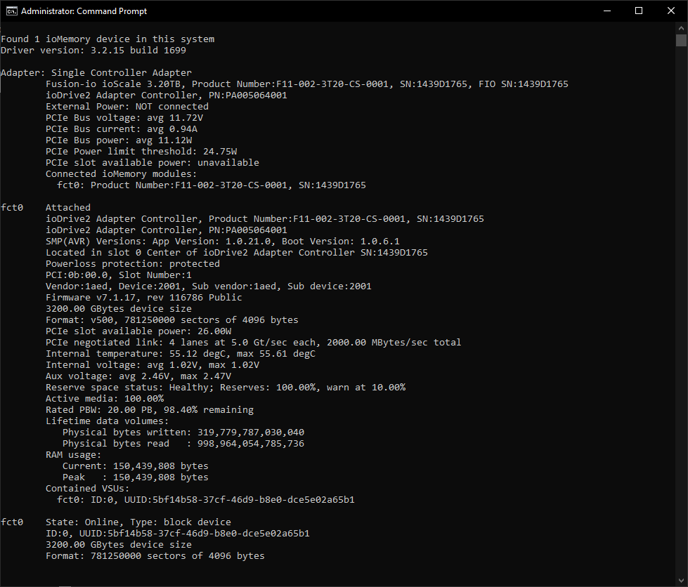

Got mine, 87.X% remaining, 100% reserves. Im happy, seems to be working OK so far. I am using the dell drivers.
My speeds are in the range everyone else seems to be getting.
Though I am surprised that I can hear this thing working.

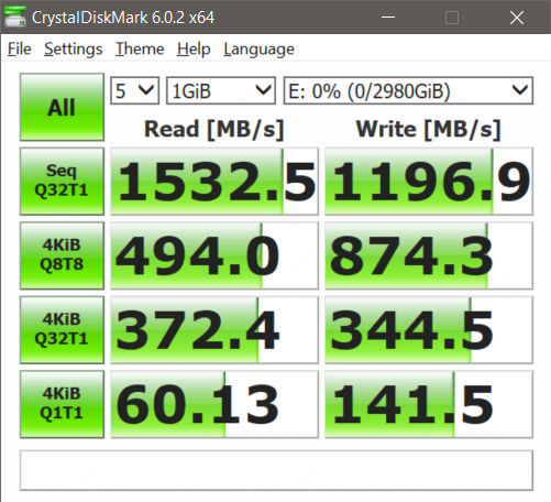

Redid my 25w Bench. During this bench it was throwing over wattage alerts throughout the write phase.
Then did 75w. No Alert anymore.
Which gave me a minor Read speed improvement, but seems to done a touch of damage to my write speeds.
Super pleased with this purchase though. Might get me acouple more years out of this ol'Xeon.

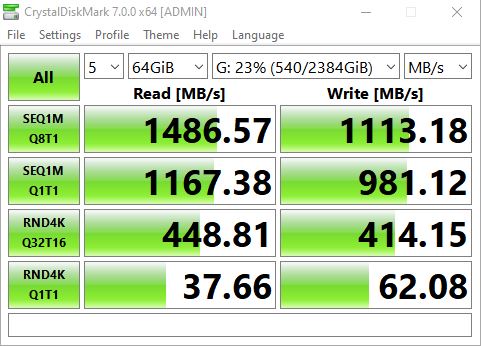

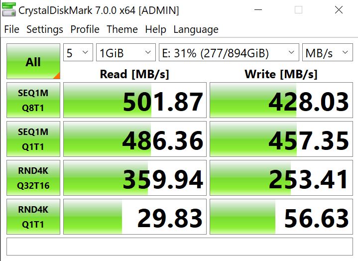

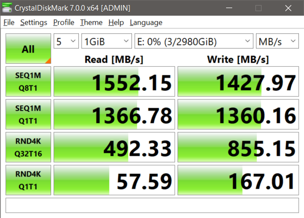

Got my drive today, info and results below! I'm pretty happy for the $135 bucks it cost me! Leaving it at 25W...seems to be happy with the throughput on a PCI-E 3.0 8X slot.
SanDisk Ultra II SATA SSD:
Toshiba/OCZ 512GB RD400s in NVMe RAID0:
ioFusion Drive:

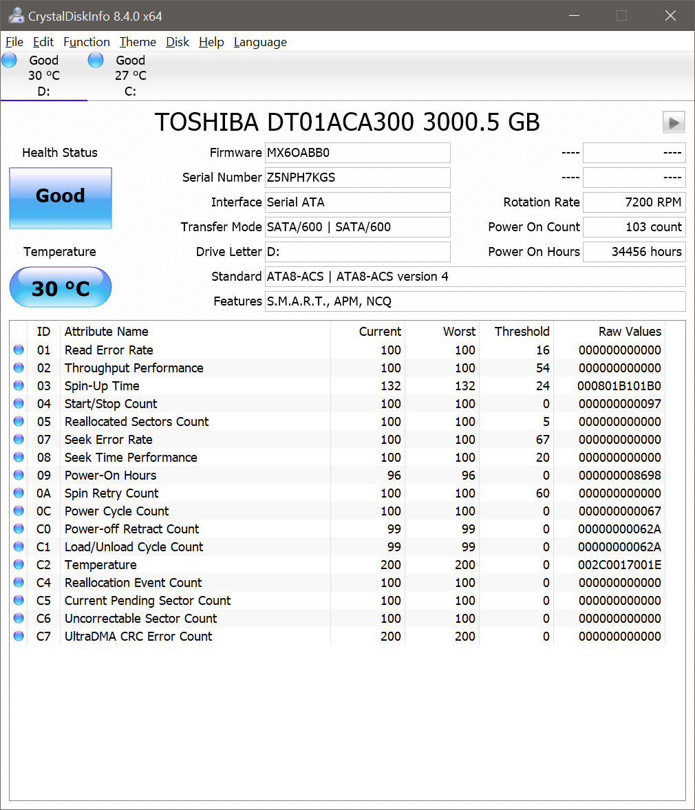

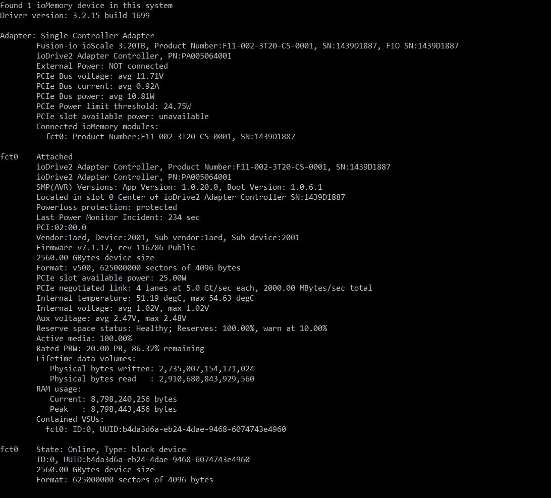

intalled mine, endurance 86.63% remaining
For reason unknown CrystalDiskInfo does not see it. Any ideas why? Windows recognize it, can read and write...

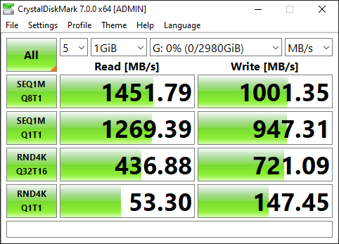

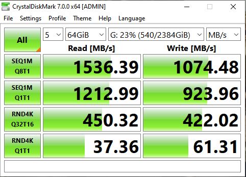

Got mine today. The seller is Save My Server (www.savemyserver.com), a well known reseller of used server gear. Normally their prices are pretty good. Located in GA.
Edit: Tested, and I'm getting CrystalDisk results in line with everyone else's. 87.74% remaining.
I've seen them around a bunch, seen pretty legit. Send pretty good, glad everyone is seeing pretty consistent #s. Thanks for the update!
