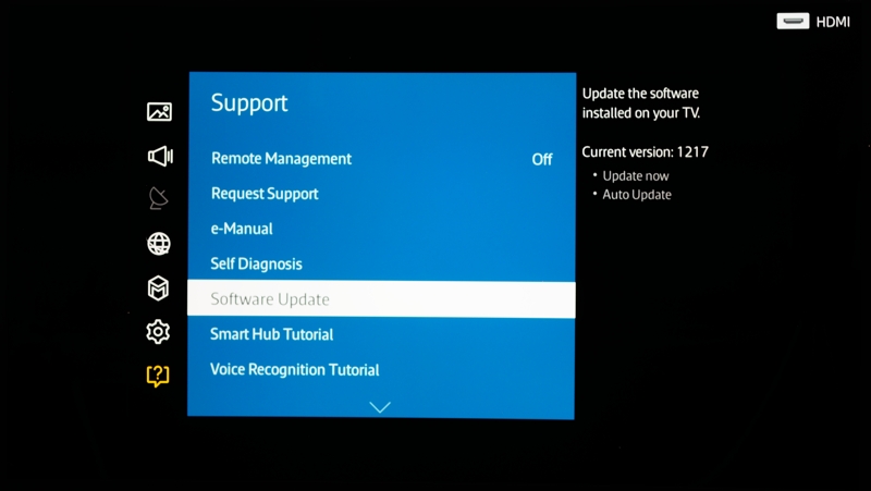

Updating to the Latest Firmware -- Objective, but Debated
Samsung has made many improvements to the firmware in these TV's in a very short period of time, and they affect the exact type of things that we as PC users of these TV's care about, namely image quality and input lag. I say this is debated above, as some of the early firmware updates on lower end models with 4 core processors (the JS9000 has an 8 core CPU) actually had negative impacts on input lag. On my JS9000 - however - I have found that every update I have received has improved input lag in PC mode without worsening quality, and improved quality in Game mode without sacrificing input lag. While some users of lower end 4 core models still use older firmware revisions as a precaution, posters in the thread who have installed more recent firmware suggest that anything 1207 or later on lower end models are a safe upgrade without bad input lag. The latest firmware at the time I am writing this is 1217.
So there is a judgment call here, you can choose to keep the existing firmware for fear that updates will increase input lag, but on the JS9000 I wouldn't . Every firmware has been a clear improvement. On the lower end models, I still probably wouldn't based on what I have heard in the thread about 1207 and on, but it is worth keeping in mind.
Time to get started. Turn on the TV and press the MENU/123 button on your remote. You should see the screen below:
Using the arrow buttons on the remote (or the fancy WII-like accelerometer controls if equipped/desired) to navigate to the top left where it says "Menu".
You should now see the menu below:
Navigate down the list and select the "Support" menu.
Once there, select the "Software Update" option.
Now select the "Update Now" option. It goes without saying, but you'll need a network connection (wired or WiFi) for this, set up in the first time setup screen.
The update will be downloaded, unpacked and installed, and the TV will reboot.

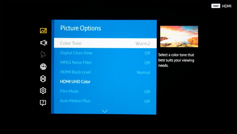

Enabling UHD mode -- Objective
This one is important! In order for your TV to receive the full color signals from your computer, at 50/60hz refresh rates, you need to enable this option. (It makes no sense to me why this wouldn't just be on by default, but I didn't design the thing)
Navigate to the menu again, like we did above, but this time select the "Picture" menu, and then scroll down to the second page, and select the "picture options" menu.
Select the "HDMI UHD Color" menu.
You will be greeted by the options below:
Select the HDMI port you are using for your computer (I am using HDMI1), and change the setting to ON. This will restart your TV.

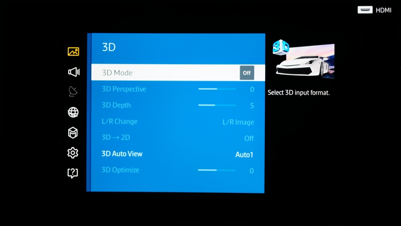

Lets start with 3D. I believe this is disabled by default, but lets just make sure it's set to "off"

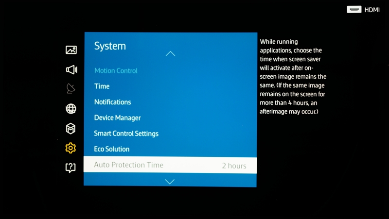

Now let's go back to the main menu, and navigate down to the "System" menu.
Scroll down until you see "ECO Solution" and select this menu.
Here I have disabled everything except "No signal power off". Firstly the ECO auto sensor is highly annoying when it randomly changes brightness on you, especially when you have multiple monitors, and now the brightness is suddenly very different between your screens. It also might just use some CPU cycles, so I'd rather have it off.

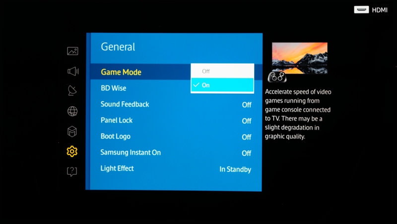

Lets return to the system menu, and now move down to the "General" menu.
We'll come back to "Game Mode" later, lets just turn everything here off for now. Samsung Instant On SOUNDS good, but in reality it can be a problem and is better off. The light effect is subjective, but I prefer to not have a LED shining in my face when I am looking at the screen, so I have it set to only come on when the TV is in standby mode.

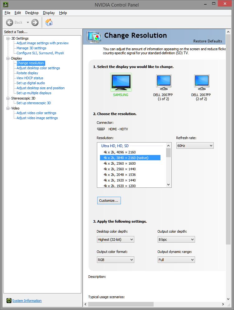

Configuring Windows:
We want to make sure we set this up before we set up any picture settings on the TV, as the TV tries to be smart, and can tell when we've changed things, and will identify the changed output settings as a different device, and use a different picture mode profile. If we change the picture mode settings first, we will lose them all, and have to do them again.
Now is as good a time as any to make sure you have fairly recent Nvidia drivers. Once installed, pull up your Nvidia settings and go to the "Change Resolution" tab.
You'll want to choose 3840x2160 as your resolution, and 60hz as your refresh rate. (These might already be selected.) Next we want to make sure that our output color is correct.
In the "Output Color Format" drop-down, select "RGB", and in the Output Dynamic Range dropdown select full. (Previously YCbCR444 was recommended due to a TV firmware bug preventing RGB mode from working properly, but this has since been fixed. Once setting RGB and Full in windows we will need to make sure that we have also set the correct "Full" level in the TV, or the colors will be compressed. I will cover this below in the "Setting up PC mode" section.
Once the settings are applied, we can move on to our picture settings, and not worry about having to redo anything.

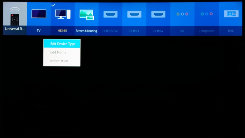

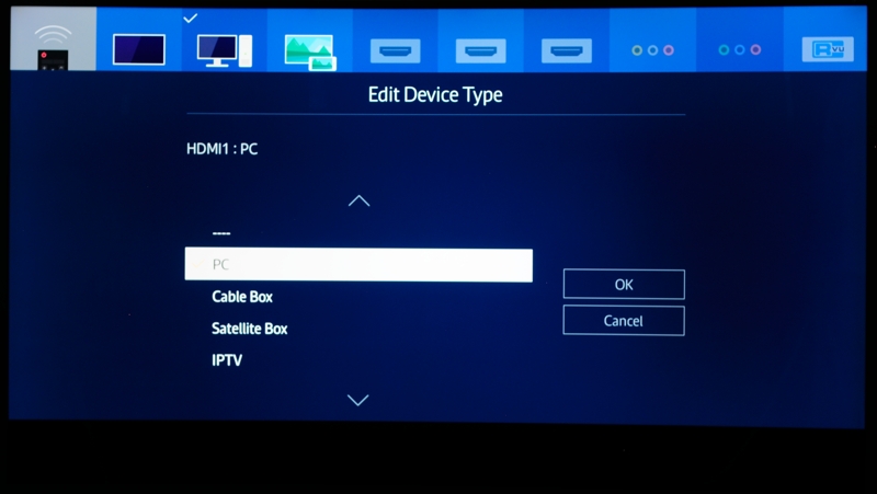

Setting up PC mode:

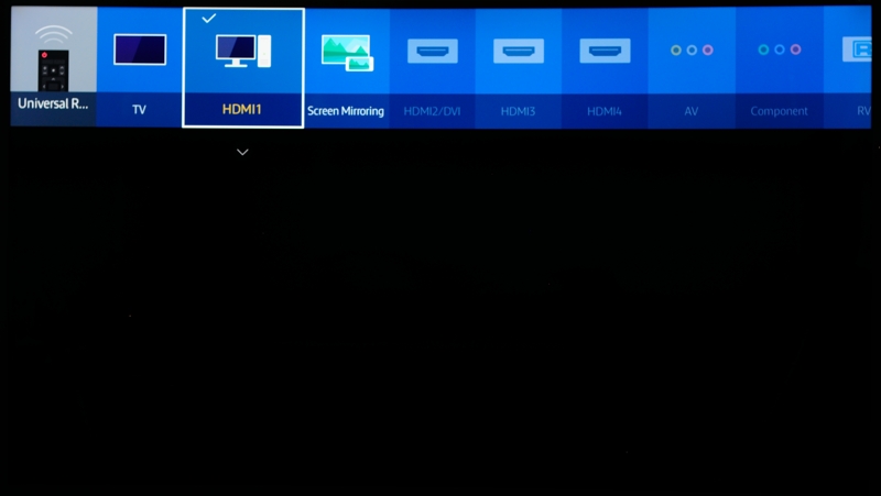

Press the "source" button on your remote, and you will see the following screen.
Navigate over and select your input (in our example HDMI1) and click the select button.
Push the down button on the remote (or long press the select button) to reveal the semi hidden input options menu.
Select "Edit Device Type"
Choose PC, and select OK.
You are now in PC mode. We have one more last setting before you can finally see the colors and quality of this screen in their full glory. Since we are using RGB mode and FULL colors, we need to make sure that we have the corresponding full mode on the TV side. Navigate to the picture settings menu (you should know how to get here by now)
Scroll down to the second page, and select "Picture Options".
Here we need to make sure that HDMI Black Level is set to "Normal". (Ignore the fact that menu option is greyed out in my screenshot above, it shouldn't be in yours)
If you want to make any preference adjustments, we can go back to the picture menu and make them there.

Scroll down in the Picture menu to "Picture Options"
Here you'll find a "Color Tone" menu. Options are "Cool", "Standard", "Warm1" and "Warm2"
I found even the warmest setting (Warm2) to be cooler than my IPS side monitors, but at least now they are pretty close.
I should note that this is the simple way to try to control white balance. If you know what you are doing, there is an advanced White Balance menu under "Menu -> Picture -> Advanced Settings" which allows further white balance tweaking, but it is beyond the scope of this writeup (and quite frankly, beyond the scope of my full understanding)

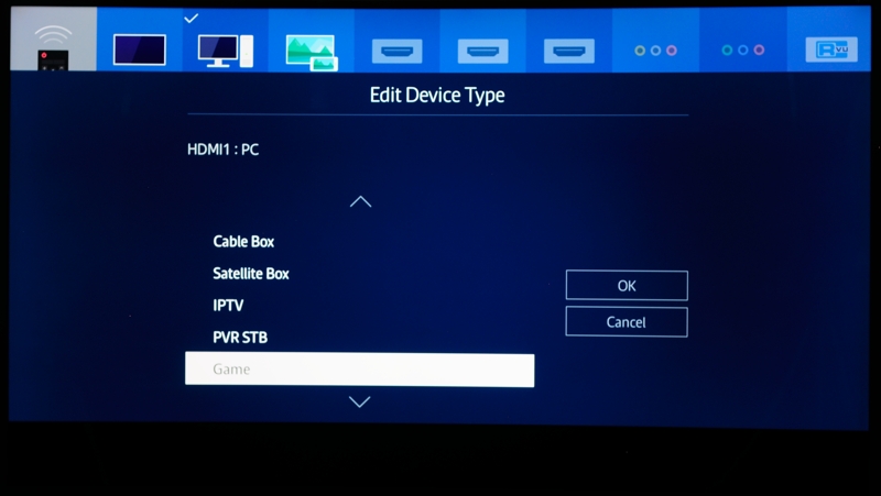

Setting up Game mode:
The PC mode looks gorgeous, but it has some ~46ms of input lag, which wile OK for desktop use, and some types of games (I'm not bothered in Civ 5, for instance) would be kind of bad in a fast paced first person shooter. Once we have properly set up game mode, we should be able to get that input lag down to ~24ms, which quite frankly, is better than any non-CRT monitor I've ever owned.
Again, lets press the "source" button on your remote.
Navigate over and select your input (in our example HDMI1) and push the down button on the remote (or long press the select button) to reveal the semi hidden input options menu again.
This time we are selecting "Game".
This is where you gasp and say, "Oh my god this looks horrible, is my gaming really going to look this bad!?" The Answer, No. Game mode DOES reduce the color level a little bit down to 4:2:2 (I think) which is enough that if you are staring at certain colors of text on certain backgrounds it might look bad, but in any game I have tried thus far, I can't tell the difference in image quality. I CAN however tell the huge difference in input lag, which is much much better. The reason it looks terrible right now is because the default settings are really bad for some reason.
First things first. Simply setting the input to "Game" does not fully enable game mode. As of right now, you still will have kind of high input lag. We need to enable it in the settings menu too. Lets navigate to the System settings menu. (You know how to get here by now)
Scroll down to the second page, and select "General".
Here, select "Game Mode" and enable it. Make sure everything else is still off.

Switching between Game Mode and PC Mode:
Some people are not very lag sensitive, and they say they just stick in PC mode all the time, even in games. Others are not very Chroma Subsampling sensitive, and they say they stay in Game Mode all the time. Personally, I can tell the difference in both, so I switch the modes all the time. Luckily, all the settings we changed are one time deals. The TV remembers them when you switch modes, so going forward we only have to change the input, and everything else is remembered.
Just to repeat, this is how we do it from now on:
Press the "source" button on your remote, and you will see the source screen.
Navigate over and select your input (in our example HDMI1) and push the down button on the remote (or long press the select button) to reveal the semi hidden input options menu.
Choose PC, or Game and choose OK.
That's all there is to it. Everything else is remembered.

After reading through it 2-3 times, I have a few minor suggestions (don't take them as criticisms, only suggestions from the viewpoint of someone who has had several different models before settling on the JS9000):
- JS8500 is listed twice under the Assumptions/Disclaimers section ;) Minor typo.
- I realize that this guide was made using the JS9000 but I would mention that that the JU6500/6700 do not come with the One Connect box; all inputs are on the back of the TV (so that people aren't expecting otherwise or think they're missing something). Also, the JU7100/7500 come with the smaller One Connect Mini while the JS8500/9000 come with the full size One Connect box (not sure about the JS7000 as it's kind of the oddball of the entire lineup)
- You did a good job explaining the difference between PC mode and Game mode. It might be beneficial to newcomers to include the two popular 4:4:4 test images so that people can verify 4:4:4 or 4:2:2 as they're following your guide, and tell them what to expect the images to look like when they are and aren't in full 4:4:4 mode.
- AMP was briefly mentioned in a later post; maybe add it into the main guide as it's commonly used as a third "mode" (PC, Game, AMP) by some of us when we want maximum fluidity and smoothness at the expense of input lag. Some might not see your other post and assume that it's not beneficial (or can't be used) when gaming.
- Include Cyph's window resize fix, as several of us have been affected by the window resizing/repositioning issue.
Again, nice job!
