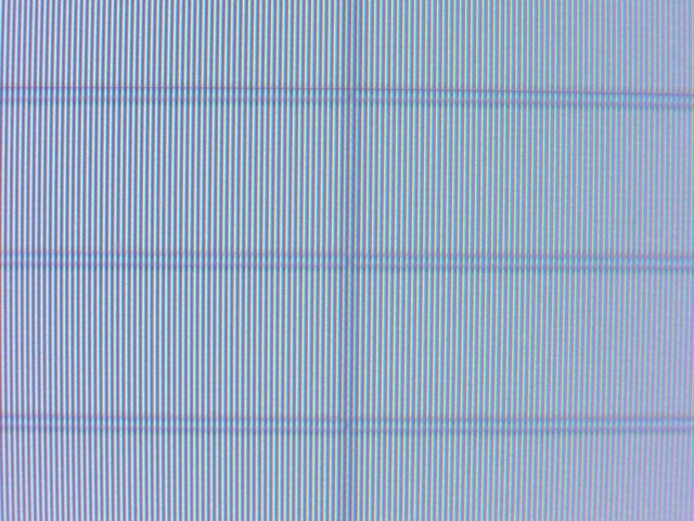

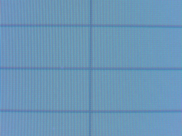

Sunfox n00bie, 4.3 Years
Sunfox is offline
FW900 Question...
I guess I'm late to this particular party - even though I've been using my FW900 since 2001!
At any rate, since about December I've been having a problem with my FW900: after it's been on for a number of hours, and typically when displaying a screen that contains a lot of white, it will suddenly turn off and flash the power LED: blink-blink pause, blink-blink pause, until I turn it off, and then back on again, where it'll work for a while longer. This problem may not happen for weeks at a time, or it may happen every 5 minutes for an hour.
I was all set to buy a new 23 or 24" LCD, but after reading about some of the issues with them (namely lag on the Samsung 244T I was going to purchase) I started looking at FW900 related material again, and came across this thread and mention of the "Image Restoration" feature that I had completly forgot about.
Well, after running restoration the screen at maximum contrast is a **lot** darker. I was reading on a newsgroup that as these monitors age they actually get brighter, and since my problem was triggered by "bright" screens I wonder if this issue was some sort of current/draw protection circuit. But, even if I haven't fixed anything, I guess I'm no worse off than before. :-)
However, I did have an actual question. As the screen is made brighter either by the brightness or contrast controls, it seems that focus (or something) goes off as things "bloom". This can be seen on a blank Excel spreadsheet - the thin light colored lines that make up the cells actually become double in the middle of the screen if you look close enough. If I turn the brightness **way** down they resolve back into a single line, but the level at which this is not an issue would make the monitor pretty much useless.
Here's a photo of the issue:
And a photo of what it looks like with brightness down:
Anyone know of a way to adjust this? This sort of drives me nuts when viewing small black text on a white background (especially compared to my notebook or the 19" LCDs I have on other family member's computers).
